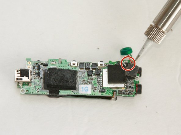

    • Next, you will need to take the new microphone and solder it to the motherboard using a soldering iron.
    • Note when using the soldering tool that the sliver bar may become too hot, so that is a part of the tool to avoid touching while in use.
