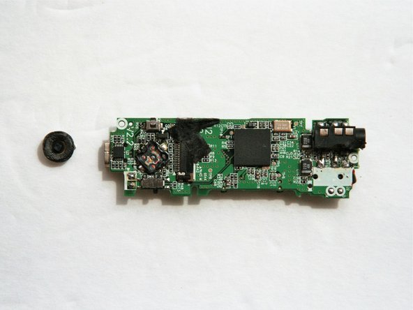

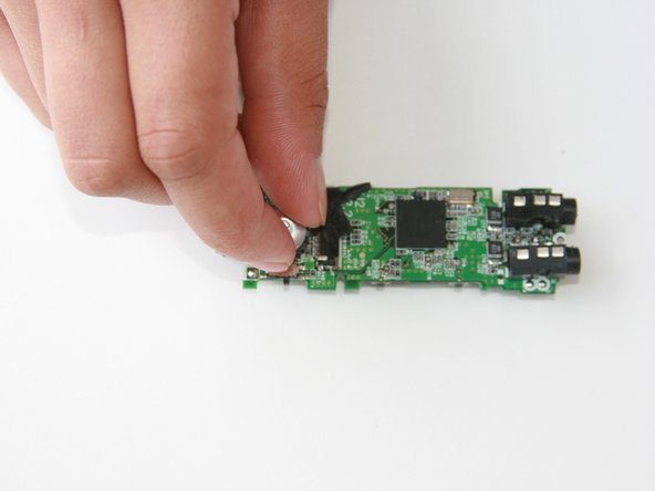

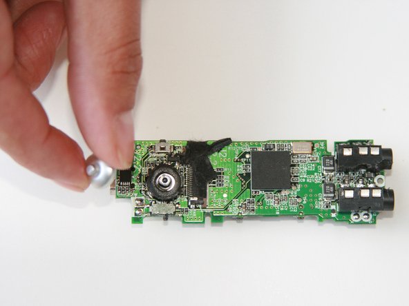

  5. Cowon iAudio U2 Joystick Replacement: crwdns2935265:05crwdnd2935265:01crwdnd2935265:03crwdne2935265:0 Cowon iAudio U2 Joystick Replacement: crwdns2935265:05crwdnd2935265:02crwdnd2935265:03crwdne2935265:0 Cowon iAudio U2 Joystick Replacement: crwdns2935265:05crwdnd2935265:03crwdnd2935265:03crwdne2935265:0
    • The silver plastic cover to the joystick will be on the front side of the device. Pull the cover off with your hand.
  6. Cowon iAudio U2 Joystick Replacement: crwdns2935265:06crwdnd2935265:01crwdnd2935265:02crwdne2935265:0 Cowon iAudio U2 Joystick Replacement: crwdns2935265:06crwdnd2935265:02crwdnd2935265:02crwdne2935265:0
    • Using the soldering tool, remove the joystick control.
    • Once the original joystick is removed, solder the new joystick controller into place.
    • The soldering tool will be hot, so be cautious when using it.
