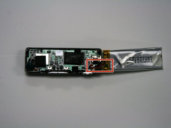

    • Now the battery should be visible. Proceed to remove it by lifting the edge of the battery.
    • The battery is stuck to the motherboard of the device.
    • Gently peel the battery off the motherboard, until you see the cables attaching the battery to the motherboard.
  4. Cowon iAudio U2 Battery Replacement: crwdns2935265:04crwdnd2935265:01crwdnd2935265:03crwdne2935265:0 Cowon iAudio U2 Battery Replacement: crwdns2935265:04crwdnd2935265:02crwdnd2935265:03crwdne2935265:0 Cowon iAudio U2 Battery Replacement: crwdns2935265:04crwdnd2935265:03crwdnd2935265:03crwdne2935265:0
    • With a gentle twist and pull, the battery will separate from the device. Make sure you pull the cables along with the battery.
    • To apply a new battery you will need a soldering kit to replace the cables back within the motherboard.

Thanks for the manual. Does anyone knows where can I buy a replacement battery?
Tobias Maul - crwdns2934203:0crwdne2934203:0
Based on the part number “042060” stamped on the side and the approximate dimensions of the device, look for a 4.0mm x 20mm x 60mm 3.7V lithium polymer battery. They are not easy to find. One example: https://www.ebay.com/itm/500mAh-3-7V-Li-...

Even with knowing the dimensions I had no success. Of course, I found some sellers which sell starting from 1000 pieces. Anyway, the batterie Steve recommended arrived after 15 days. I cannot say anything about the durability, but the device is now working again. Exchange was very easy and did take less then 30 minutes. I am happy to further use the device (sound is even better then a samrtphone).
