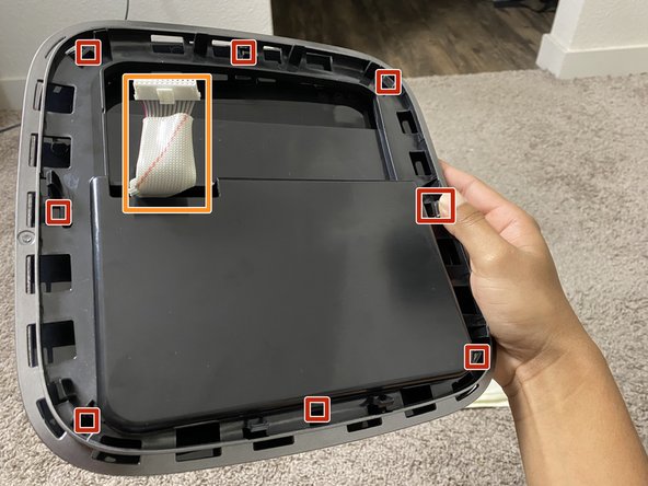

    • Use an iFixit opening tool to pry open the top lid of your air fryer.
  2. Cosori TurboBlaze Control Panel Replacement: crwdns2935265:02crwdnd2935265:01crwdnd2935265:02crwdne2935265:0 Cosori TurboBlaze Control Panel Replacement: crwdns2935265:02crwdnd2935265:02crwdnd2935265:02crwdne2935265:0
    • Detach the white wire harness bundle from the main device.

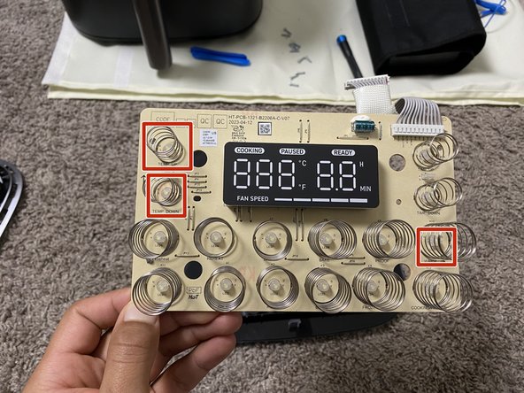

  6. Cosori TurboBlaze Control Panel Replacement: crwdns2935265:06crwdnd2935265:01crwdnd2935265:02crwdne2935265:0 Cosori TurboBlaze Control Panel Replacement: crwdns2935265:06crwdnd2935265:02crwdnd2935265:02crwdne2935265:0
    • Flip the circuit board over to its backside to access the input controls.
    • If any input controls show signs of wear, cuts, or bends, then they must be replaced.
