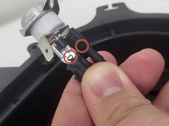

  16. Cosori Pro II Power Cord Replacement, Cord: crwdns2935265:016crwdnd2935265:01crwdnd2935265:03crwdne2935265:0 Cosori Pro II Power Cord Replacement, Cord: crwdns2935265:016crwdnd2935265:02crwdnd2935265:03crwdne2935265:0 Cosori Pro II Power Cord Replacement, Cord: crwdns2935265:016crwdnd2935265:03crwdnd2935265:03crwdne2935265:0
    • Unhook the wires from the plastic hook.
    • Remove the two Phillips #2 screws that secure the blue and pink cables.
    • Use a Phillips #1 screwdriver to remove the single screw.
  17. Cosori Pro II Power Cord Replacement: crwdns2935265:017crwdnd2935265:01crwdnd2935265:01crwdne2935265:0
    • Use a Phillips #0 screwdriver to remove the two screws that secure the cylinder.
  18. Cosori Pro II Power Cord Replacement: crwdns2935265:018crwdnd2935265:01crwdnd2935265:02crwdne2935265:0 Cosori Pro II Power Cord Replacement: crwdns2935265:018crwdnd2935265:02crwdnd2935265:02crwdne2935265:0
    • Push the cylinder out.
    • Apply force to the hook on the connectors to take off the wires.
