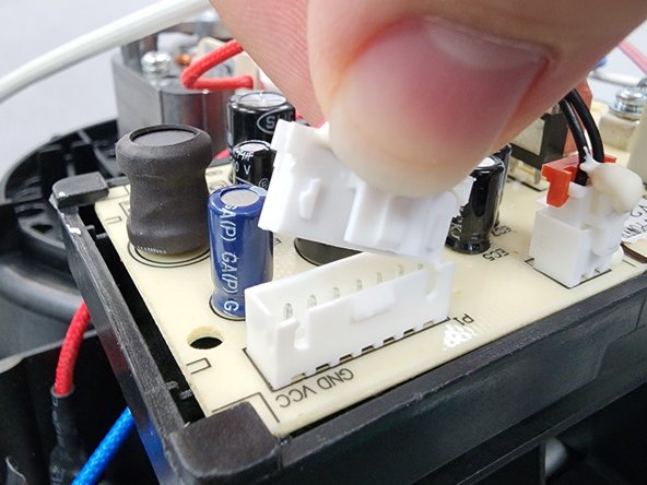

    • Depress the white clip and disconnect the screen connector.

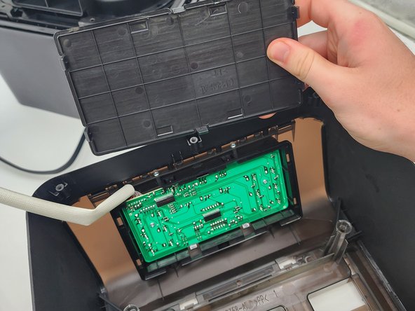

    • Remove the plastic panel.
  9. Cosori Pro II Motherboard Replacement: crwdns2935265:09crwdnd2935265:01crwdnd2935265:01crwdne2935265:0
    • Remove the two screws with a Phillips #1 screwdriver.

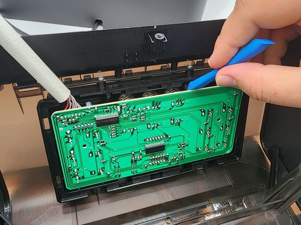

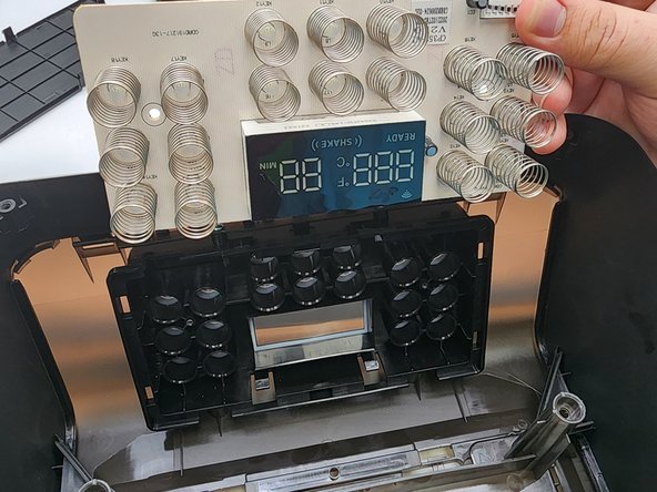

  10. Cosori Pro II Motherboard Replacement: crwdns2935265:010crwdnd2935265:01crwdnd2935265:03crwdne2935265:0 Cosori Pro II Motherboard Replacement: crwdns2935265:010crwdnd2935265:02crwdnd2935265:03crwdne2935265:0 Cosori Pro II Motherboard Replacement: crwdns2935265:010crwdnd2935265:03crwdnd2935265:03crwdne2935265:0
    • Apply force simultaneously to the four hooks to release the mother board.
    • Using a prying tool pull out the springs on the mother board from their sockets.
    • Remove the motherboard.
