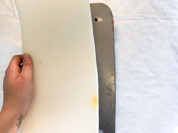

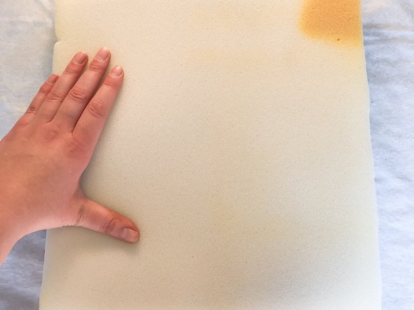

    • Cut two pieces of foam for each seat cushion.
    • Bottom seat: 14" x 12"
    • Back rest: 14" x 6"

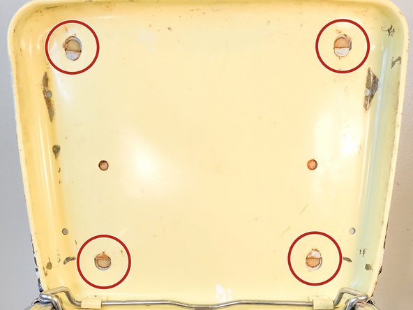

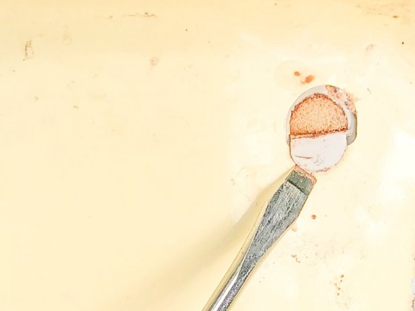

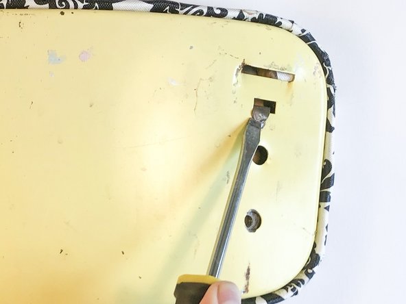

    • To detach the seat, lift up the seat and use a flathead screwdriver to lift up all four tabs underneath.
  5. Cosco Stylaire Step Stool (44-B) Upholstery Replacement: crwdns2935265:05crwdnd2935265:01crwdnd2935265:01crwdne2935265:0

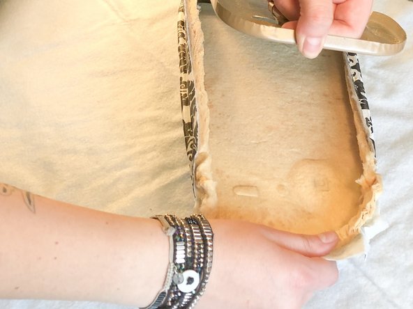

    • Use the flathead screwdriver to pry the top of the seat off.
    • The base of the seat will stay attached to the stool.

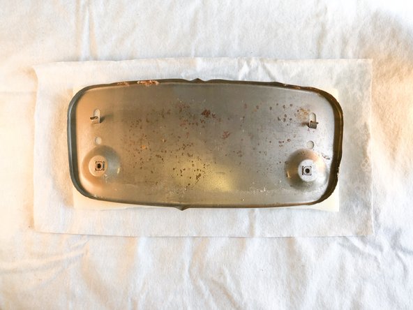

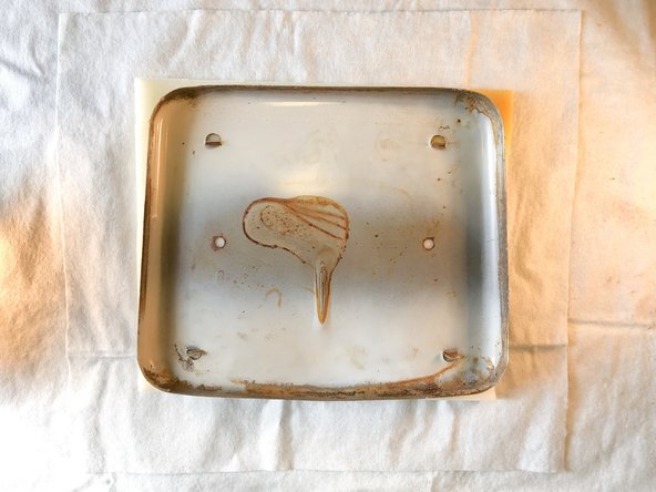

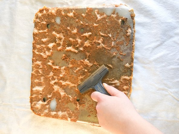

    • Remove old materials from each metal seat plate.
    • You may need to use a paint scraper to scrape off the foam.
  8. Cosco Stylaire Step Stool (44-B) Upholstery Replacement: crwdns2935265:08crwdnd2935265:01crwdnd2935265:01crwdne2935265:0
    • Clean off any rust using vinegar and paper towels.

    • Use the spray adhesive to spray the metal plates and apply the foam to their respective pieces.
    • Let it sit for five minutes to dry.

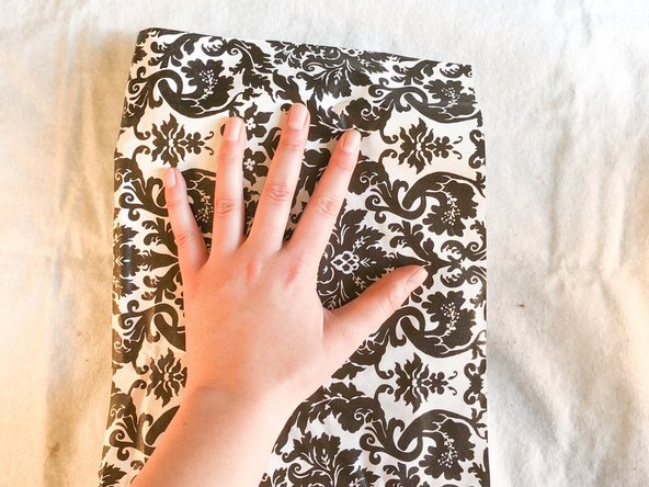

    • Smooth cloth onto each metal plate, pushing from the center, outwards.

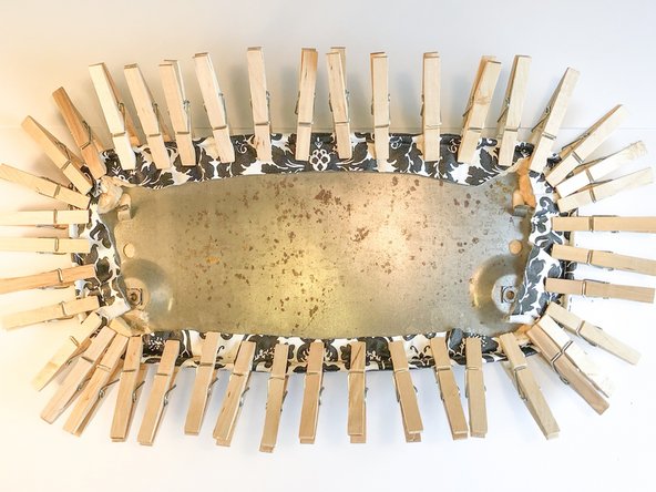

  12. Cosco Stylaire Step Stool (44-B) Upholstery Replacement: crwdns2935265:012crwdnd2935265:01crwdnd2935265:02crwdne2935265:0 Cosco Stylaire Step Stool (44-B) Upholstery Replacement: crwdns2935265:012crwdnd2935265:02crwdnd2935265:02crwdne2935265:0
    • Fold the cloth up over the sides and clothespin it down along all four edges.
    • Let it dry for at least one hour.
To reassemble your device, follow steps 3-5 in reverse order, using a hammer to push down the tabs.
