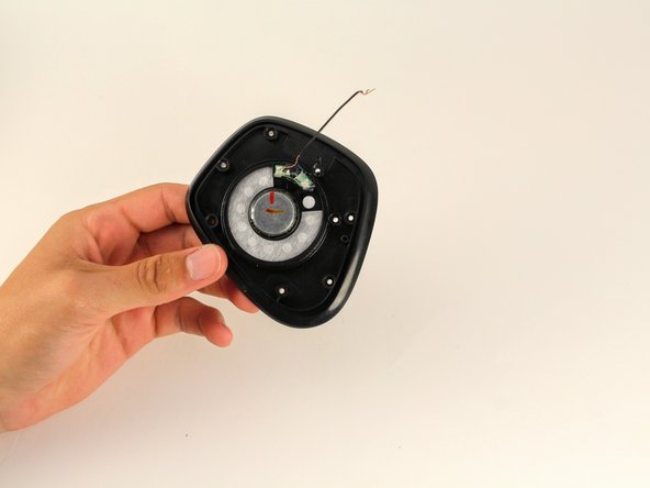

  4. Corsair Void Pro RGB Speakers Replacement, Speakers: crwdns2935265:04crwdnd2935265:01crwdnd2935265:01crwdne2935265:0
    • Desolder the wire that connects to the speaker.
    • For steps on how to solder, see this helpful guide.
  5. Corsair Void Pro RGB Speakers Replacement: crwdns2935265:05crwdnd2935265:01crwdnd2935265:02crwdne2935265:0 Corsair Void Pro RGB Speakers Replacement: crwdns2935265:05crwdnd2935265:02crwdnd2935265:02crwdne2935265:0
    • Use a knife tool as a wedge to remove the speaker and glue in the new speaker.

Where can i find a new speaker ?
brunodehulster - crwdns2934203:0crwdne2934203:0
The speaker listed in the parts, is not the correct speaker. I purchased them and they are NOT a fit.
ksmith - crwdns2934203:0crwdne2934203:0
Whats the size of the speaker?
smack2k - crwdns2934203:0crwdne2934203:0
The size of the speaker is 50 mm and about 10 mm in depth. I used this speaker in my own repair and it worked well.
