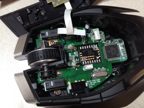

    4. Corsair Vengeance M65 Mouse Cable Replacement: crwdns2935265:04crwdnd2935265:01crwdnd2935265:03crwdne2935265:0 Corsair Vengeance M65 Mouse Cable Replacement: crwdns2935265:04crwdnd2935265:02crwdnd2935265:03crwdne2935265:0 Corsair Vengeance M65 Mouse Cable Replacement: crwdns2935265:04crwdnd2935265:03crwdnd2935265:03crwdne2935265:0
      • If you wish to go any further, please do so at your own risk. I have not gone further than this.
      • There are two screws that hold the PCB in place. One is longer than the other. The SHORT one goes to where I am pointing. The long screw holds down a grounding wire. Move the wire out of the way as you take out the board.
      • There is a ribbon cable that I am pointing at which you can pull out. There are some multi-colored wires that are plugged into the board. Wiggle it out. Move it to the side when you take the board out.
      • Now lift the PCB out along with the scroll wheel. There should be some more screws which hold the metal to the plastic. Undo those if you want to.
      • The sides come apart. You must take the mainboard out in order to take the sides off. There are two latches for the left side and four on the right side. The left side also has two screws securing it to the rest of the body.

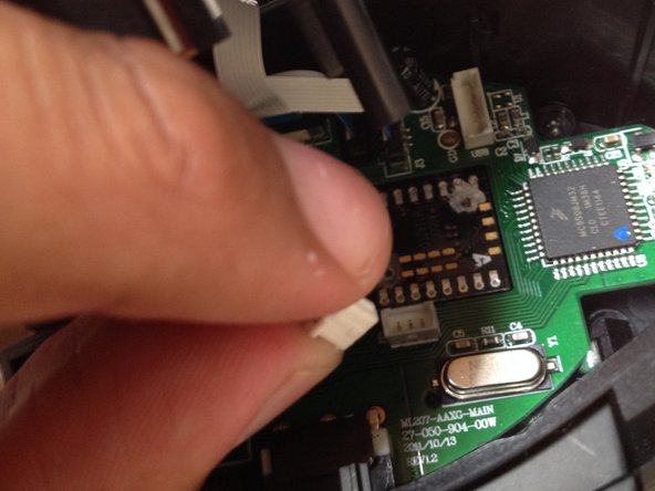

    1. Corsair Vengeance M65 Mouse Cable Replacement, Opening that mouse! and removing connections: crwdns2935265:05crwdnd2935265:01crwdnd2935265:03crwdne2935265:0 Corsair Vengeance M65 Mouse Cable Replacement, Opening that mouse! and removing connections: crwdns2935265:05crwdnd2935265:02crwdnd2935265:03crwdne2935265:0 Corsair Vengeance M65 Mouse Cable Replacement, Opening that mouse! and removing connections: crwdns2935265:05crwdnd2935265:03crwdnd2935265:03crwdne2935265:0
      • Once you've opened the mouse remove the power connector.
      • Remove the other connector present gently, as they're fragile.
      • Be aware of the very long ribbon still cable in place.

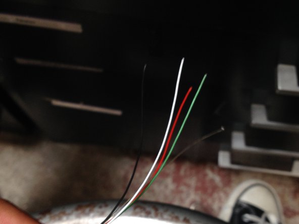

    2. Corsair Vengeance M65 Mouse Cable Replacement, Wire Stripping: crwdns2935265:06crwdnd2935265:01crwdnd2935265:03crwdne2935265:0 Corsair Vengeance M65 Mouse Cable Replacement, Wire Stripping: crwdns2935265:06crwdnd2935265:02crwdnd2935265:03crwdne2935265:0 Corsair Vengeance M65 Mouse Cable Replacement, Wire Stripping: crwdns2935265:06crwdnd2935265:03crwdnd2935265:03crwdne2935265:0
      • When I first opened this, I found my power connector in this sorry state but I guess it could have been worse.
      • Start stripping the wires so that you can solder them, then run the wires through the hole.
      • Begin soldering the wires: Red+red,white+ white, green+green, black+black, and that really thick black cable+plus the other thick cable or the silver one
      • Don't forget to wrap the exposed wires in electrical tape (Will post pictures of repaired mouse later)
      • Hopefully you have done everything you could and now your mouse is working again!
