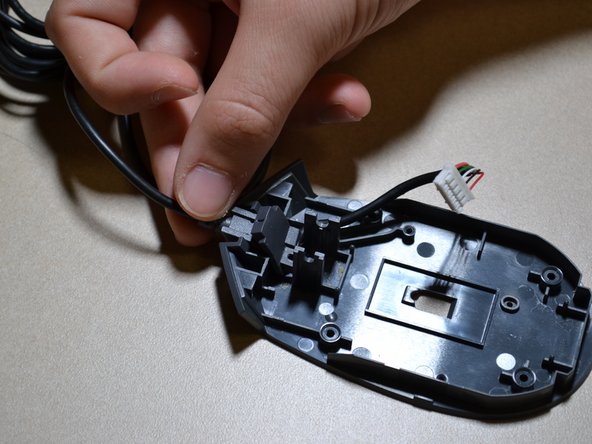

  7. Corsair Katar USB Cable Replacement: crwdns2935265:07crwdnd2935265:01crwdnd2935265:02crwdne2935265:0 Corsair Katar USB Cable Replacement: crwdns2935265:07crwdnd2935265:02crwdnd2935265:02crwdne2935265:0
    • Use the JIS 0 screwdriver to remove the 5mm screw attached to the USB wire housing.
    • Lift the USB wire away from the shell of the mouse.
    • When reassembling the device, run the USB wire through the channel on the bottom of the shell to keep it in place.
