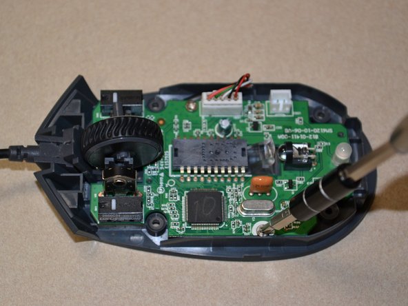

  5. Corsair Katar Scroll Wheel Sensor, Scroll Wheel: crwdns2935265:05crwdnd2935265:01crwdnd2935265:02crwdne2935265:0 Corsair Katar Scroll Wheel Sensor, Scroll Wheel: crwdns2935265:05crwdnd2935265:02crwdnd2935265:02crwdne2935265:0
    • Use the JIS 0 screwdriver to remove the two 5mm screws on the motherboard.
  6. Corsair Katar Scroll Wheel Sensor: crwdns2935265:06crwdnd2935265:01crwdnd2935265:01crwdne2935265:0
    • Use the plastic opening tool to pry the white cable jack away from the motherboard.
    • Lift the motherboard away from the bottom of the mouse.

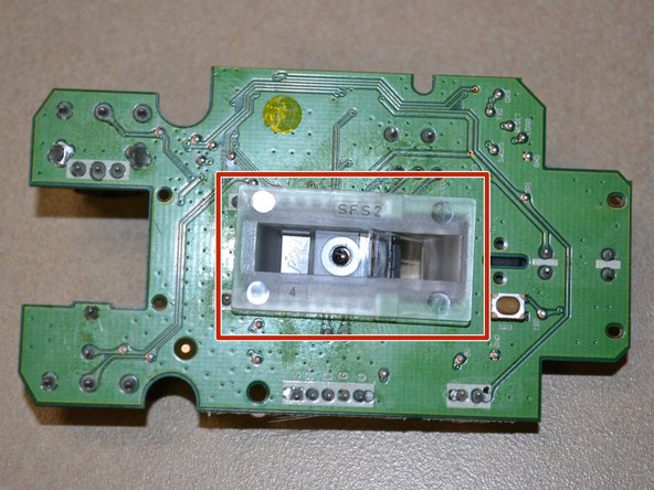

    • Flip the motherboard over and remove the clear plastic cover from the bottom of the board.

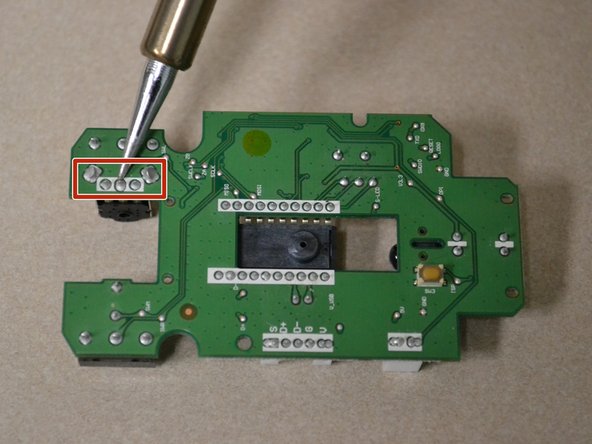

  9. Corsair Katar Scroll Wheel Sensor: crwdns2935265:09crwdnd2935265:01crwdnd2935265:02crwdne2935265:0 Corsair Katar Scroll Wheel Sensor: crwdns2935265:09crwdnd2935265:02crwdnd2935265:02crwdne2935265:0
    • Desolder the 5 connecting pins to remove the scroll wheel sensor from the motherboard.
