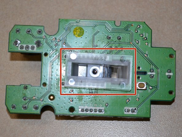

  8. Corsair Katar Optical Sensor Replacement, Optical Sensor: crwdns2935265:08crwdnd2935265:01crwdnd2935265:02crwdne2935265:0 Corsair Katar Optical Sensor Replacement, Optical Sensor: crwdns2935265:08crwdnd2935265:02crwdnd2935265:02crwdne2935265:0
    • Flip the motherboard over and remove the clear plastic cover from the bottom of the board.

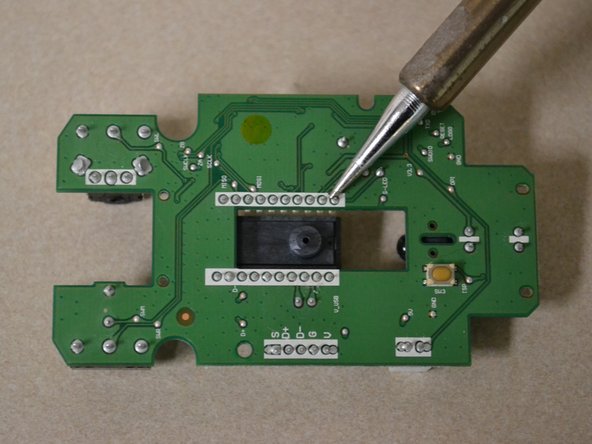

  9. Corsair Katar Optical Sensor Replacement: crwdns2935265:09crwdnd2935265:01crwdnd2935265:02crwdne2935265:0 Corsair Katar Optical Sensor Replacement: crwdns2935265:09crwdnd2935265:02crwdnd2935265:02crwdne2935265:0
    • Desolder the 20 connecting pins to remove the optical sensor.
