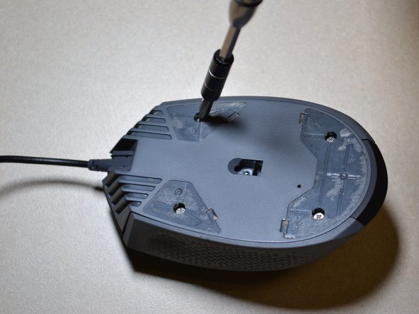

  3. Corsair Katar Disassembly: crwdns2935265:03crwdnd2935265:01crwdnd2935265:02crwdne2935265:0 Corsair Katar Disassembly: crwdns2935265:03crwdnd2935265:02crwdnd2935265:02crwdne2935265:0
    • Use the JIS 0 screwdriver to remove the four 5 mm screws on the bottom of the mouse.
  4. Corsair Katar Disassembly: crwdns2935265:04crwdnd2935265:01crwdnd2935265:01crwdne2935265:0
    • Detach the bottom of the mouse from the upper shell.
    • Remove the shell slowly so as not to damage the white DPI cable inside the mouse.
    • Use the plastic opening tool to detach the white DPI sensor cable from its port.
    • Alternatively, you can use your hand to remove the DPI sensor cable by wiggling it out of the port.
