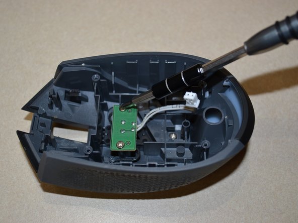

  5. Corsair Katar DPI Sensor Replacement, DPI Sensor: crwdns2935265:05crwdnd2935265:01crwdnd2935265:02crwdne2935265:0 Corsair Katar DPI Sensor Replacement, DPI Sensor: crwdns2935265:05crwdnd2935265:02crwdnd2935265:02crwdne2935265:0
    • Use the JIS 0 screwdriver to remove the two 5mm screws holding the DPI sensor.
  6. Corsair Katar DPI Sensor Replacement: crwdns2935265:06crwdnd2935265:01crwdnd2935265:01crwdne2935265:0
    • Lift the DPI sensor away from the mouse shell.
