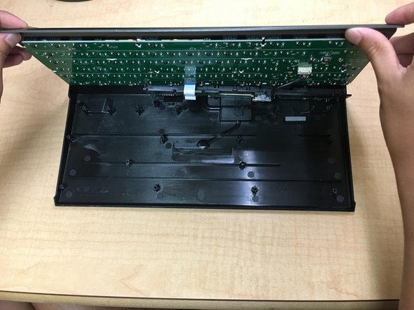

  6. Corsair K65 disassembly Water Damage cleaning: crwdns2935265:06crwdnd2935265:01crwdnd2935265:02crwdne2935265:0 Corsair K65 disassembly Water Damage cleaning: crwdns2935265:06crwdnd2935265:02crwdnd2935265:02crwdne2935265:0
    • Carefully separate the bottom half of the keyboard from the top half of the keyboard.
    The plastic par with the LEDs and volume buttons is detachable from the plastic shell. You might need to lever it off carefully.
    St Schiff - crwdns2934203:0crwdne2934203:0
    After you detach the metal plate from the plastic, a small, 1-2cm long semi transparent white plastic bar with two spikes may fall out. This goes between the LEDs and the metal plate to dim and even the light!

broke the white and blue connector, no way to get the board in the same orientation as you did.
qwuzzy - crwdns2934203:0crwdne2934203:0
Extremely bad guide. Doesn’t go over how the switch to change the LEDs need to be carefully moved away or it will snap. I can’t imagine how many people you’ve costed a keyboard. 0/5 stars.
ah93493 - crwdns2934203:0crwdne2934203:0
Nice guide, helped me to clean the board after I spilled a drink on my beloved board. ade some comments at points that proved difficult for me. Unfortunately I only understood what the white plastic thingie that fell out is used for after I reassembled the keyboard. It is supposed to sit on the LEDs to dim them and even out the light.
