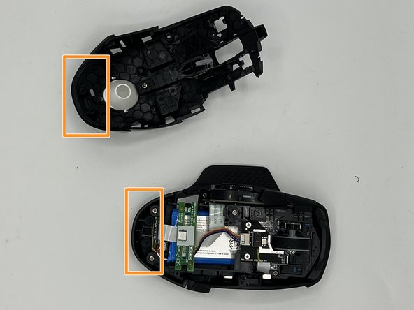

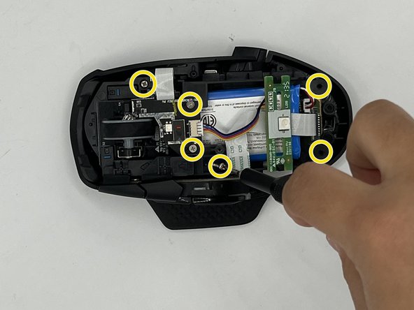

  3. Corsair Dark Core RGB PRO SE Battery Replacement: crwdns2935265:03crwdnd2935265:01crwdnd2935265:03crwdne2935265:0 Corsair Dark Core RGB PRO SE Battery Replacement: crwdns2935265:03crwdnd2935265:02crwdnd2935265:03crwdne2935265:0 Corsair Dark Core RGB PRO SE Battery Replacement: crwdns2935265:03crwdnd2935265:03crwdnd2935265:03crwdne2935265:0
    • Remove the two screws that were underneath the left and right buttons using a Phillips #00 screwdriver.
    • Place the spudger in between the shell and the bottom of the mouse, releasing the latch.
    • Do not try to remove the top shell by pulling it up as it might break the latch.
    • Remove the six screws using a Phillips #00 screwdriver.

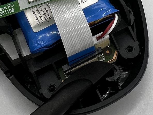

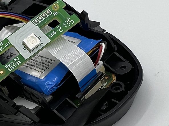

  4. Corsair Dark Core RGB PRO SE Battery Replacement: crwdns2935265:04crwdnd2935265:01crwdnd2935265:03crwdne2935265:0 Corsair Dark Core RGB PRO SE Battery Replacement: crwdns2935265:04crwdnd2935265:02crwdnd2935265:03crwdne2935265:0 Corsair Dark Core RGB PRO SE Battery Replacement: crwdns2935265:04crwdnd2935265:03crwdnd2935265:03crwdne2935265:0
    • Remove the circuit board by pushing the two latches holding it in place in opposite directions.
    • Unplug the ribbon cable by pushing the black connector holding it in place.
    • Disconnect the battery cord by pulling it up.
  5. Corsair Dark Core RGB PRO SE Battery Replacement: crwdns2935265:05crwdnd2935265:01crwdnd2935265:01crwdne2935265:0
    • Remove the battery with a spudger or your fingers.
