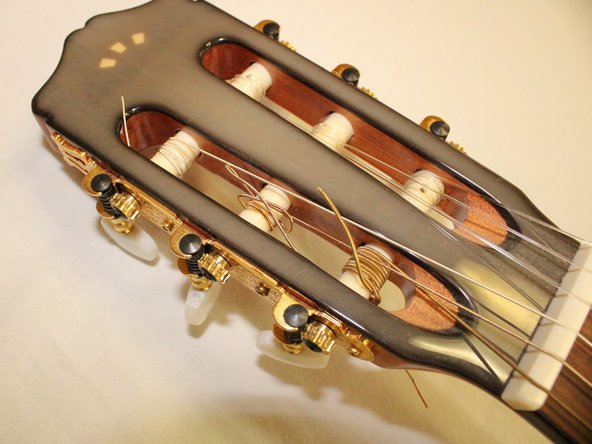

    • Loosen the guitar string by turning the tuning peg in a counterclockwise direction.
    • The string should be completely loose.

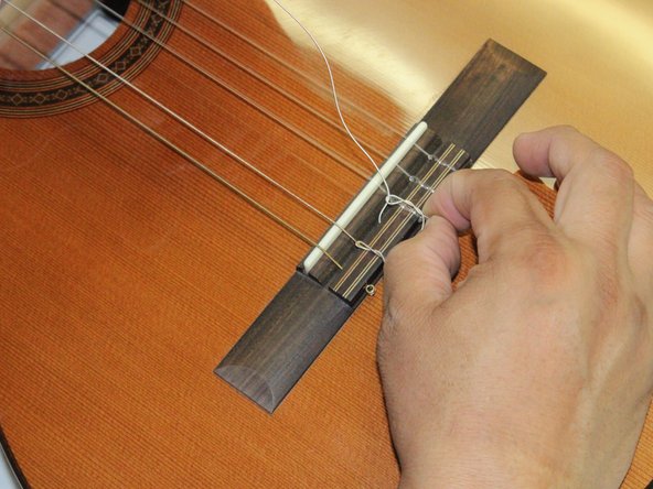

    • Remove the old string from the bridge by undoing the knot and pulling it out from the bridge hole.

    • Remove the other end of the old string from the headstock by undoing the knot on the barrel and pulling it out of the barrel hole.

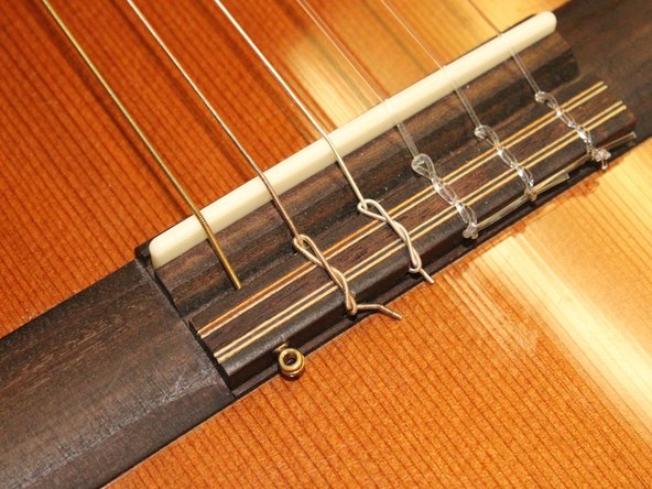

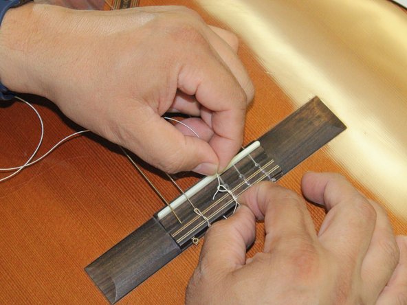

    • Take your new nylon guitar string and feed one end into the bridge hole.
    • Leave enough string at the base of the body to tie a knot.
    • To tie the knot, hold onto the longer end of the string with your left hand and grab the end of the short string with your right hand. Wrap the end of the short string back around itself two times. The string should resemble a figure-8 pattern.
    • Hold down the knot on the bridge with your fingers and pull the longer end of the string with your left hand to tighten the knot.

    • Feed the other end of the string over the barrel hole. Bring the string over the barrel again and feed it into the barrel hole.
    • This will create a loop that secures the string on the barrel.

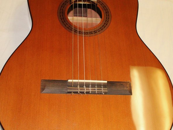

    • With your right hand, keep the string tense so that the knot at the bridge does not come undone.
    • Turn the tuning peg clockwise to tighten the string.
  7. Cordoba C5 Classical Guitar String Replacement: crwdns2935265:07crwdnd2935265:01crwdnd2935265:03crwdne2935265:0 Cordoba C5 Classical Guitar String Replacement: crwdns2935265:07crwdnd2935265:02crwdnd2935265:03crwdne2935265:0 Cordoba C5 Classical Guitar String Replacement: crwdns2935265:07crwdnd2935265:03crwdnd2935265:03crwdne2935265:0
    • Check the bridge and headstock to ensure the string is secure.
    • If you have excess string at the headstock, trim it with cutting pliers for a neater look.
