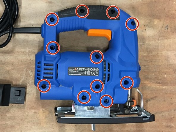

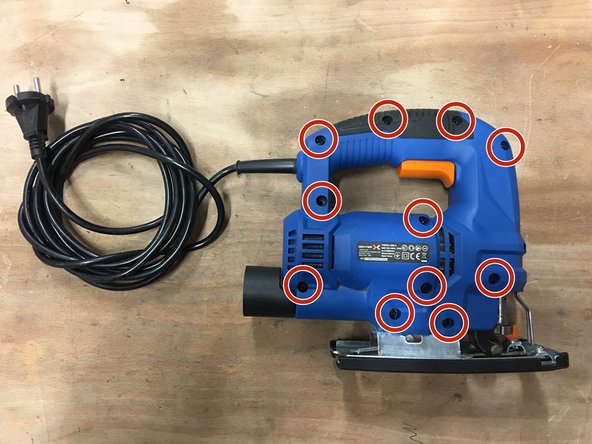

    • Remove the vacuum adapter from the back of the device.
  3. Corded Jigsaw Dexter 750W Blade Roller Replacement: crwdns2935265:03crwdnd2935265:01crwdnd2935265:02crwdne2935265:0 Corded Jigsaw Dexter 750W Blade Roller Replacement: crwdns2935265:03crwdnd2935265:02crwdnd2935265:02crwdne2935265:0
    • Using a screwdriver or screwdriver, unscrew and open the device

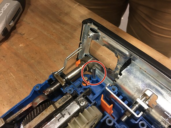

    • Unlock the tray by lifting the lever.
    • Use pliers to remove the tip.
    • Then remove the rod, still using the pliers.

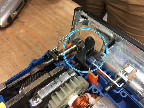

    • Replace the new rod.
    • Then the black tip.
  5. Corded Jigsaw Dexter 750W Blade Roller Replacement: crwdns2935265:06crwdnd2935265:01crwdnd2935265:01crwdne2935265:0
    • Close and screw the device.
To reassemble follow the guide through or in reverse.
