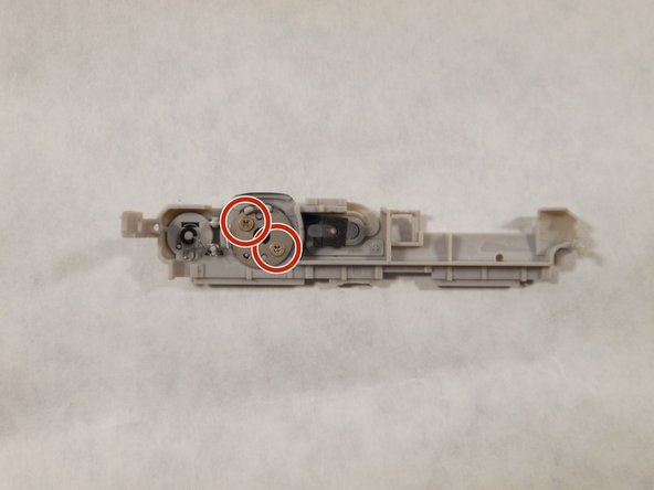

    3. Coolpix S01 Zoom Trigger Replacement: crwdns2935265:03crwdnd2935265:01crwdnd2935265:02crwdne2935265:0 Coolpix S01 Zoom Trigger Replacement: crwdns2935265:03crwdnd2935265:02crwdnd2935265:02crwdne2935265:0
      • After the battery is out, remove the gray button bar from the top of the camera with the smallest opening tool.
      • With the gray bar detached from the camera, turn it upside down. With the Hex and the J000 bit remove the two 1mm screws.
    4. Coolpix S01 Zoom Trigger Replacement: crwdns2935265:04crwdnd2935265:01crwdnd2935265:02crwdne2935265:0 Coolpix S01 Zoom Trigger Replacement: crwdns2935265:04crwdnd2935265:02crwdnd2935265:02crwdne2935265:0
      • Take the needle nose tweezers to remove the black ring in the middle of the button.
      • You have successfully removed the zoom trigger and can replace with a new one if needed.
