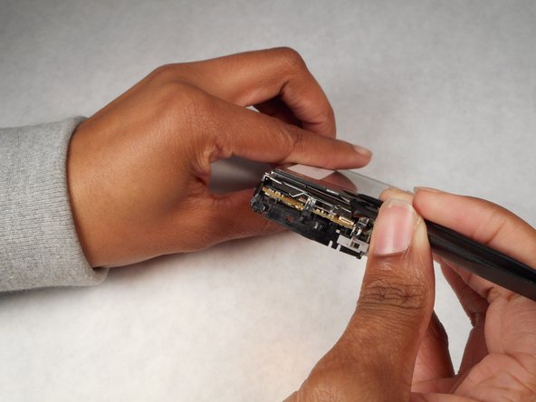

  3. Coolpix S01 Screen Cover Replacement: crwdns2935265:03crwdnd2935265:01crwdnd2935265:03crwdne2935265:0 Coolpix S01 Screen Cover Replacement: crwdns2935265:03crwdnd2935265:02crwdnd2935265:03crwdne2935265:0 Coolpix S01 Screen Cover Replacement: crwdns2935265:03crwdnd2935265:03crwdnd2935265:03crwdne2935265:0
    • With the screen facing outward, locate the orange ribbon cable from the motherboard.
    • With the straight tweezers, gently pull out the orange ribbon cable from the motherboard.

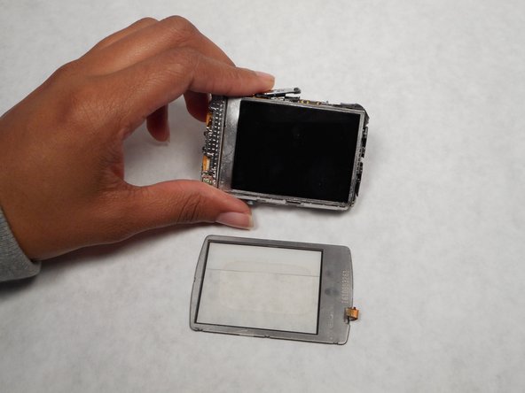

  4. Coolpix S01 Screen Cover Replacement: crwdns2935265:04crwdnd2935265:01crwdnd2935265:03crwdne2935265:0 Coolpix S01 Screen Cover Replacement: crwdns2935265:04crwdnd2935265:02crwdnd2935265:03crwdne2935265:0 Coolpix S01 Screen Cover Replacement: crwdns2935265:04crwdnd2935265:03crwdnd2935265:03crwdne2935265:0
    • With the lens facing down and the bottom of the camera facing away from you, lift up the right edge of the LCD screen.
    • Use the plastic tool to gently lift the screen out from the upper left corner until the seal is broken.
