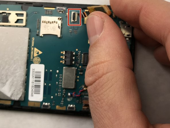

  5. Coolpad 3300A Screen Replacement, Screen: crwdns2935265:05crwdnd2935265:01crwdnd2935265:02crwdne2935265:0 Coolpad 3300A Screen Replacement, Screen: crwdns2935265:05crwdnd2935265:02crwdnd2935265:02crwdne2935265:0
    • Remove the ribbon cable by flipping up the connector.
  6. Coolpad 3300A Screen Replacement: crwdns2935265:06crwdnd2935265:01crwdnd2935265:01crwdne2935265:0
    • Remove second ribbon cable shown in red box. To do this repeat step 5.

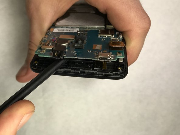

  7. Coolpad 3300A Screen Replacement: crwdns2935265:07crwdnd2935265:01crwdnd2935265:03crwdne2935265:0 Coolpad 3300A Screen Replacement: crwdns2935265:07crwdnd2935265:02crwdnd2935265:03crwdne2935265:0 Coolpad 3300A Screen Replacement: crwdns2935265:07crwdnd2935265:03crwdnd2935265:03crwdne2935265:0
    • Use the nylon spudger to gently pry/release clips to remove motherboard from the screen.
