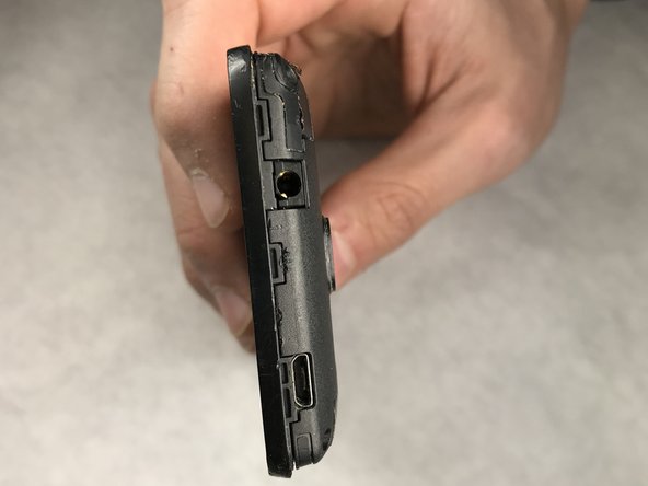

  3. Coolpad 3300A Camera Replacement: crwdns2935265:03crwdnd2935265:01crwdnd2935265:03crwdne2935265:0 Coolpad 3300A Camera Replacement: crwdns2935265:03crwdnd2935265:02crwdnd2935265:03crwdne2935265:0 Coolpad 3300A Camera Replacement: crwdns2935265:03crwdnd2935265:03crwdnd2935265:03crwdne2935265:0
    • Use a metal spudger to release all of the clips around the phone. These clips are used to hold the front and back panel on the phone together.

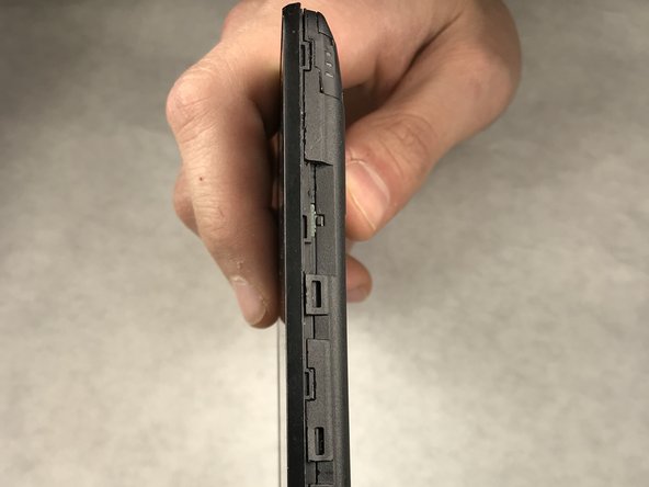

  4. Coolpad 3300A Camera Replacement: crwdns2935265:04crwdnd2935265:01crwdnd2935265:01crwdne2935265:0
    • After the clips are released, carefully separate the back housing from the phone. Notice the sticker that appears in the red box holds the phone together, but can be peeled apart.

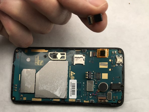

  5. Coolpad 3300A Camera Replacement, Camera: crwdns2935265:05crwdnd2935265:01crwdnd2935265:02crwdne2935265:0 Coolpad 3300A Camera Replacement, Camera: crwdns2935265:05crwdnd2935265:02crwdnd2935265:02crwdne2935265:0
    • Carefully use the nylon spudger to pry the camera from its connector.
