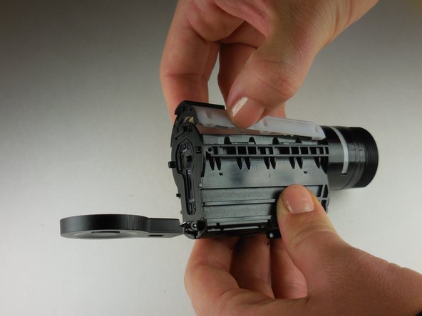

    4. Contour Roam2 Lens Unit Replacement: crwdns2935265:04crwdnd2935265:01crwdnd2935265:03crwdne2935265:0 Contour Roam2 Lens Unit Replacement: crwdns2935265:04crwdnd2935265:02crwdnd2935265:03crwdne2935265:0 Contour Roam2 Lens Unit Replacement: crwdns2935265:04crwdnd2935265:03crwdnd2935265:03crwdne2935265:0
      • Grab the camera on both sides and slide the outer shell forward until completely removed.

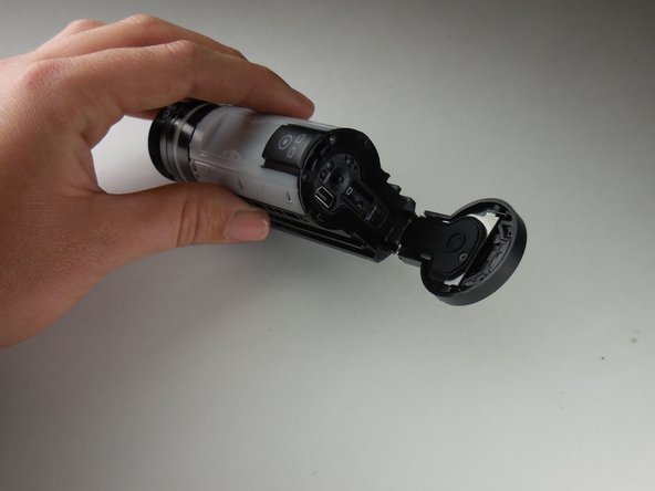

      • Open the back door by your thumb and index finger on sides of back door and pull upward.
    2. Contour Roam2 Lens Unit Replacement: crwdns2935265:011crwdnd2935265:01crwdnd2935265:02crwdne2935265:0 Contour Roam2 Lens Unit Replacement: crwdns2935265:011crwdnd2935265:02crwdnd2935265:02crwdne2935265:0

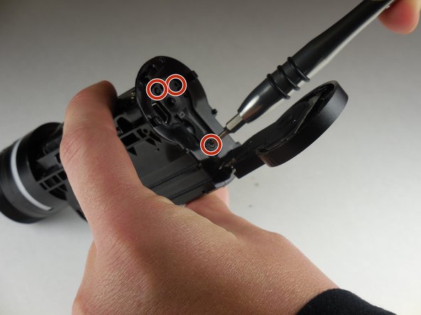

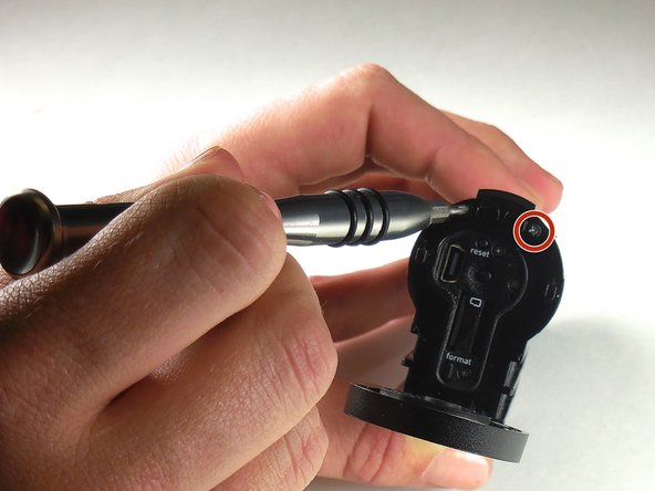

      • With the phillips head screwdriver (PH000) remove the two 3.31mm (.130inch) screws located at the top, above the reset button.
    3. Contour Roam2 Lens Unit Replacement: crwdns2935265:012crwdnd2935265:01crwdnd2935265:01crwdne2935265:0
      • Also with phillips head screwdriver (PH000) remove the six 6.07mm (0.239in) screws along sides of large white piece.
      • The screws in the camera are very small and can strip very easily. Apply consistent pressure when removing screws.

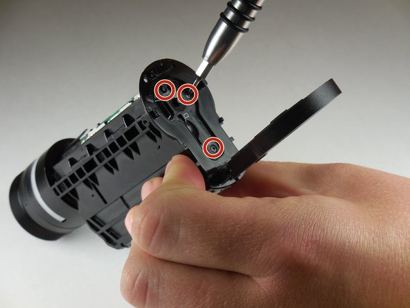

      • Using the phillips head screwdriver (PH 000), remove the remaining three 3.78 mm (0.1445 in) screws located on the back panel of the camera.
      • If you have not done so already, remove the microSD card.

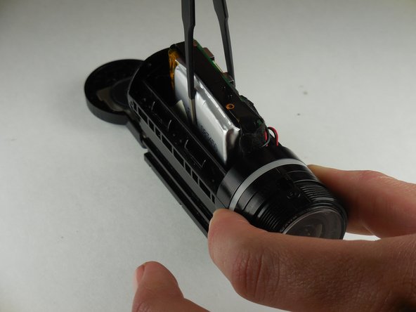

      • Using flathead tweezers, remove the logic board and the battery from the camera.

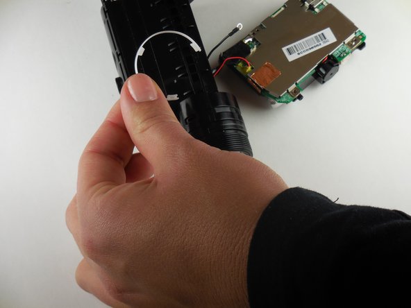

      • Using a phillips head screwdriver (PH 000), remove the screw connecting the lens unit to the logic board.
    12. Contour Roam2 Lens Unit Replacement: crwdns2935265:021crwdnd2935265:01crwdnd2935265:02crwdne2935265:0 Contour Roam2 Lens Unit Replacement: crwdns2935265:021crwdnd2935265:02crwdnd2935265:02crwdne2935265:0
      • Remove the semicircular white plastic strip near the lens unit.
    13. Contour Roam2 Lens Unit Replacement: crwdns2935265:022crwdnd2935265:01crwdnd2935265:02crwdne2935265:0 Contour Roam2 Lens Unit Replacement: crwdns2935265:022crwdnd2935265:02crwdnd2935265:02crwdne2935265:0
      • Twist lens unit until able to easily remove

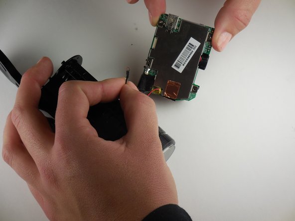

    14. Contour Roam2 Lens Unit Replacement: crwdns2935265:023crwdnd2935265:01crwdnd2935265:02crwdne2935265:0 Contour Roam2 Lens Unit Replacement: crwdns2935265:023crwdnd2935265:02crwdnd2935265:02crwdne2935265:0

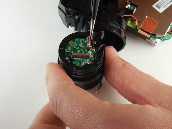

      • Disconnect the ribbon connector connecting the lens unit to the logic board.
    15. Contour Roam2 Lens Unit Replacement: crwdns2935265:024crwdnd2935265:01crwdnd2935265:02crwdne2935265:0 Contour Roam2 Lens Unit Replacement: crwdns2935265:024crwdnd2935265:02crwdnd2935265:02crwdne2935265:0
      • Remove the ribbon connecter from the lens unit by soldering.
