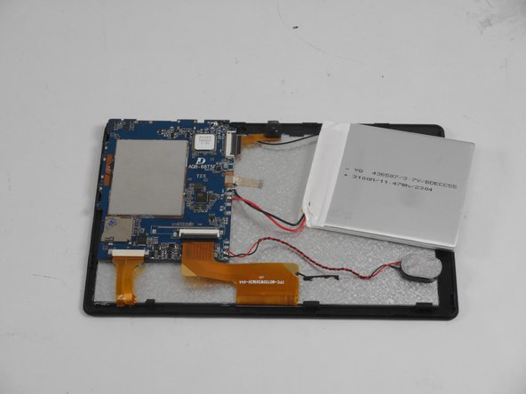

      • Remove the three 1.4 mm screws from the motherboard with the Phillips size #000 screwdriver.

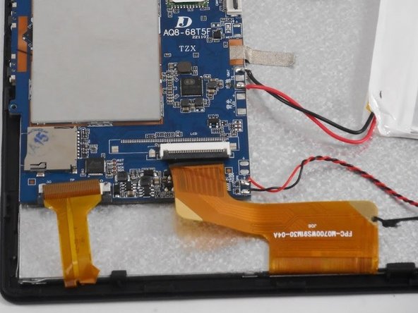

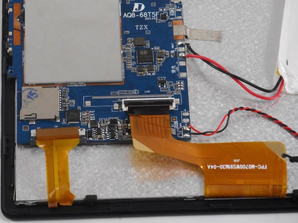

    3. Contixo V8 Motherboard Replacement: crwdns2935265:03crwdnd2935265:01crwdnd2935265:03crwdne2935265:0 Contixo V8 Motherboard Replacement: crwdns2935265:03crwdnd2935265:02crwdnd2935265:03crwdne2935265:0 Contixo V8 Motherboard Replacement: crwdns2935265:03crwdnd2935265:03crwdnd2935265:03crwdne2935265:0
      • The cable marked in red is locked into place by two dark pull tabs; pull each away from the cream connection port towards the edge of the tablet. Gently remove the cable once the tabs are in the open position.
      • This cable must be reattached by inserting its end into the port with a moderate amount of force (to ensure proper connection) and then sliding both dark locking tabs back into place against the cream port.
      • The cables marked in orange are known as zero-insert force cables. To remove the connection, flip up the dark tab and gently pull the ribbon away.
      • ZIF ribbon cables must be reattached by sliding the cable into place (without force, as implied by the name) and flipping the dark locking tab back into place. Please see this guide if you're having issues reattaching the ZIF cables.

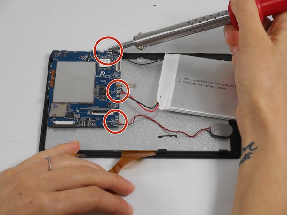

      • Use the spudger tool to break the adhesive holding the battery down and lift it off of the base of the tablet. One of the blue iFixit opening tools can also be used in place of the spudger.
      • Press the soldering tip to the 3 connection points to detach the motherboard and the battery. See this guide for information and tips on soldering and desoldering.
      • You will need to reattach these connection points when reassembling your device with the soldering iron. This guide will walk you through how to do that.
      • Exercise caution when desoldering the battery, especially if you've had issues with the device's power which could point to it being faulty. Consider using an anti-static wrist strap when working with the battery and its cables.

      • Remove the motherboard from the base of the device. It is now ready to be replaced.
