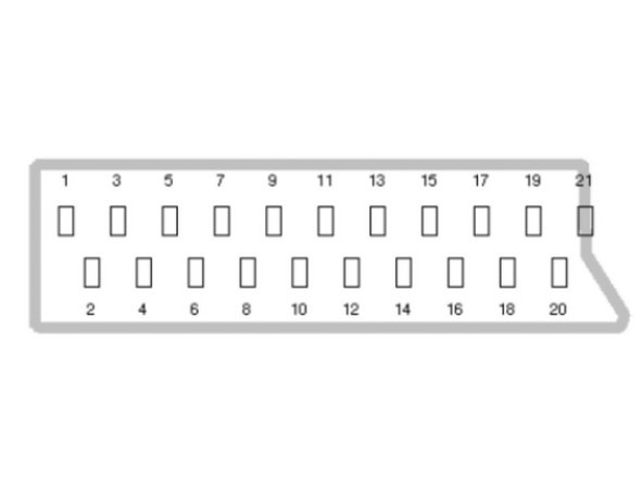

  4. Continuïteitstest van een Scart Male / 3 RCA-kabel: crwdns2935265:04crwdnd2935265:01crwdnd2935265:03crwdne2935265:0 Continuïteitstest van een Scart Male / 3 RCA-kabel: crwdns2935265:04crwdnd2935265:02crwdnd2935265:03crwdne2935265:0 Continuïteitstest van een Scart Male / 3 RCA-kabel: crwdns2935265:04crwdnd2935265:03crwdnd2935265:03crwdne2935265:0
    • Using the table, locate which signal corresponds to each pin then place the red terminal on the chosen pin on the socket then place the black terminal on the pins of each RCA plug simultaneously
    • 1. Multimeter rings = pin chosen by the two terminals matched
    • 2. Multimeter does not ring = change the terminal on the scart plug and if none rings then the cable is damaged
    • You can now know which pins correspond to which signal
