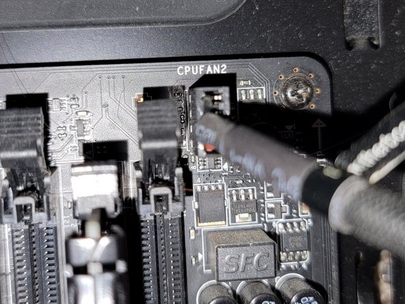

    • Orange- CPU Fan 1
    • Yellow- CPU Fan 2

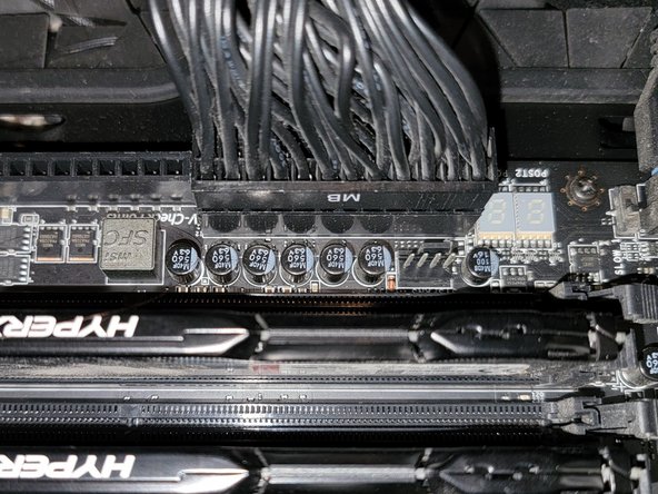

    • Green- Main ATX Connectors

  4. Connecting Cables to the Motherboard, CPU Fan 2: crwdns2935265:04crwdnd2935265:01crwdnd2935265:02crwdne2935265:0 Connecting Cables to the Motherboard, CPU Fan 2: crwdns2935265:04crwdnd2935265:02crwdnd2935265:02crwdne2935265:0
    • Connect the four pin segment to the four pin PCIE port labeled "CPUFAN2."
  5. Connecting Cables to the Motherboard, Main ATX Connector: crwdns2935265:05crwdnd2935265:01crwdnd2935265:02crwdne2935265:0 Connecting Cables to the Motherboard, Main ATX Connector: crwdns2935265:05crwdnd2935265:02crwdnd2935265:02crwdne2935265:0
    • Connect the 24 pin segment to the 24 pin PCIE port.

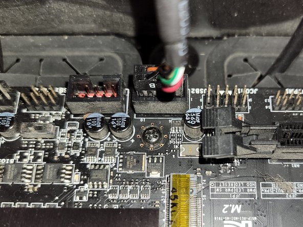

  7. Connecting Cables to the Motherboard, Panel Connectors (Part 1): crwdns2935265:07crwdnd2935265:01crwdnd2935265:03crwdne2935265:0 Connecting Cables to the Motherboard, Panel Connectors (Part 1): crwdns2935265:07crwdnd2935265:02crwdnd2935265:03crwdne2935265:0 Connecting Cables to the Motherboard, Panel Connectors (Part 1): crwdns2935265:07crwdnd2935265:03crwdnd2935265:03crwdne2935265:0
    • This PCIE port consists of eight pins, two rows of four.
    • Connect the "Power LED+" pin to the pin at the top right corner.
    • Connect the "Power LED-" segment to the pin next to the "Power LED+" segment in the top row.
    • Connect the "Power SW" segment to the two pins on the left side of the top row of pins.
  8. Connecting Cables to the Motherboard, Panel Connectors (Part 2): crwdns2935265:08crwdnd2935265:01crwdnd2935265:03crwdne2935265:0 Connecting Cables to the Motherboard, Panel Connectors (Part 2): crwdns2935265:08crwdnd2935265:02crwdnd2935265:03crwdne2935265:0 Connecting Cables to the Motherboard, Panel Connectors (Part 2): crwdns2935265:08crwdnd2935265:03crwdnd2935265:03crwdne2935265:0
    • Connect the "HDD LED" segment to the two pins on the right side of the bottom row of pins.
    • Connect the "Reset SW" segment to the two pins on the left side of the bottom row of pins.
  9. Connecting Cables to the Motherboard, USB Connector: crwdns2935265:09crwdnd2935265:01crwdnd2935265:02crwdne2935265:0 Connecting Cables to the Motherboard, USB Connector: crwdns2935265:09crwdnd2935265:02crwdnd2935265:02crwdne2935265:0
    • Connect the nine pin segment to the nine pin PCIE port.
  10. Connecting Cables to the Motherboard, HD Audio: crwdns2935265:010crwdnd2935265:01crwdnd2935265:02crwdne2935265:0 Connecting Cables to the Motherboard, HD Audio: crwdns2935265:010crwdnd2935265:02crwdnd2935265:02crwdne2935265:0
