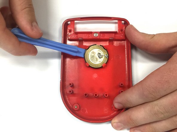

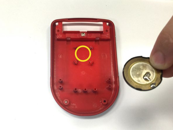

  4. Connect Four Electronic Handheld Speaker Replacement, Replacing the speaker: crwdns2935265:04crwdnd2935265:01crwdnd2935265:03crwdne2935265:0 Connect Four Electronic Handheld Speaker Replacement, Replacing the speaker: crwdns2935265:04crwdnd2935265:02crwdnd2935265:03crwdne2935265:0 Connect Four Electronic Handheld Speaker Replacement, Replacing the speaker: crwdns2935265:04crwdnd2935265:03crwdnd2935265:03crwdne2935265:0
    • If the speaker is in working condition, but the wires are broken or disconnected, skip this step and move on to step 5.
    • Locate the speaker on the back casing.
    • Using a spudger, wedge the speaker out of its place until it slides out.
    • Take the replacement speaker and wedge it back into its space.
  5. Connect Four Electronic Handheld Speaker Replacement, Re-Soldering the Speaker Wire: crwdns2935265:05crwdnd2935265:01crwdnd2935265:01crwdne2935265:0
    • Using a soldering iron, solder both red wires to their appropriate connections.
    • Be extremely careful when using a soldering iron! Contact with the tip could cause severe burns.
