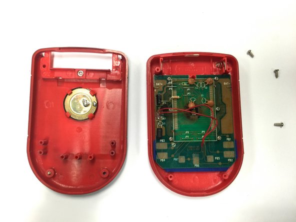

  3. Connect Four Electronic Handheld Buttons Replacement, Removing/Replacing the Back Casing: crwdns2935265:03crwdnd2935265:01crwdnd2935265:02crwdne2935265:0 Connect Four Electronic Handheld Buttons Replacement, Removing/Replacing the Back Casing: crwdns2935265:03crwdnd2935265:02crwdnd2935265:02crwdne2935265:0
    • Using a Phillips head screwdriver, remove the four (7.1mm- length) #3 screws that hold the back casing in place.
    • Carefully remove the back casing.
    • When removing the back casing, make sure not to rupture the wires that connect the speaker to the circuit board.

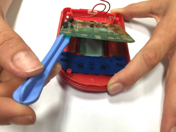

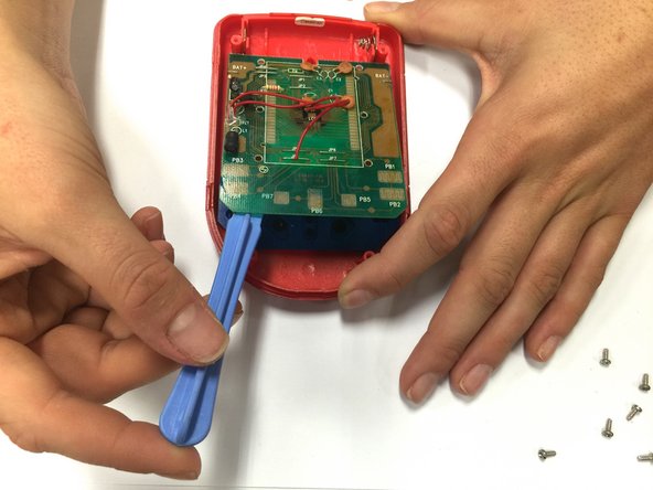

  4. Connect Four Electronic Handheld Buttons Replacement, Detaching the Circuit Board: crwdns2935265:04crwdnd2935265:01crwdnd2935265:03crwdne2935265:0 Connect Four Electronic Handheld Buttons Replacement, Detaching the Circuit Board: crwdns2935265:04crwdnd2935265:02crwdnd2935265:03crwdne2935265:0 Connect Four Electronic Handheld Buttons Replacement, Detaching the Circuit Board: crwdns2935265:04crwdnd2935265:03crwdnd2935265:03crwdne2935265:0
    • Using a Phillips head screwdriver, remove the six (0.25"-length) #3 screws that hold down the cpu board.
    • Using a spudger, lever the circuit board just enough to where you can easily access the button sheet.
  5. Connect Four Electronic Handheld Buttons Replacement, Removing/ Replacing the Button Sheet: crwdns2935265:05crwdnd2935265:01crwdnd2935265:01crwdne2935265:0
    • Take out the button sheet, and replace it with a new one.
