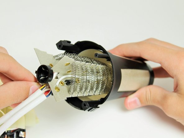

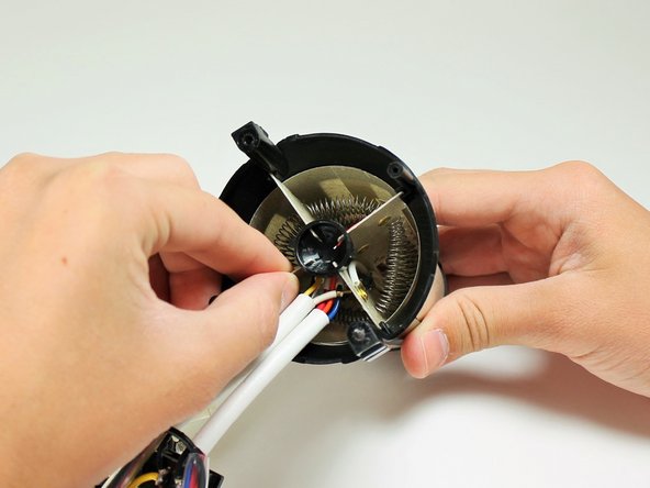

  6. Conair Infiniti Pro Model 259NP Heat Shield Replacement, Heat Shield: crwdns2935265:06crwdnd2935265:01crwdnd2935265:03crwdne2935265:0 Conair Infiniti Pro Model 259NP Heat Shield Replacement, Heat Shield: crwdns2935265:06crwdnd2935265:02crwdnd2935265:03crwdne2935265:0 Conair Infiniti Pro Model 259NP Heat Shield Replacement, Heat Shield: crwdns2935265:06crwdnd2935265:03crwdnd2935265:03crwdne2935265:0
    • If you recently used the hair dryer, the heating element may still be hot! Do not attempt this guide, you may severely burn yourself.
    • Hold the heating element with the wider end facing upward.
    • Gently pull the heating element out of the heat shield.
  7. Conair Infiniti Pro Model 259NP Heat Shield Replacement: crwdns2935265:07crwdnd2935265:01crwdnd2935265:01crwdne2935265:0
    • Gently pull the heat shield out of its sheath.
