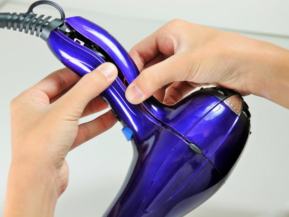

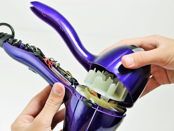

  3. Conair Infiniti Pro Model 259NP Fan Motor Assembly Replacement: crwdns2935265:03crwdnd2935265:01crwdnd2935265:03crwdne2935265:0 Conair Infiniti Pro Model 259NP Fan Motor Assembly Replacement: crwdns2935265:03crwdnd2935265:02crwdnd2935265:03crwdne2935265:0 Conair Infiniti Pro Model 259NP Fan Motor Assembly Replacement: crwdns2935265:03crwdnd2935265:03crwdnd2935265:03crwdne2935265:0
    • Starting from where the cord attaches to the handle, pull apart the two plastic panels.
    • Continue separating the back panel, working along the seam.
    • With moderate force, completely remove the back panel from the hair dryer.

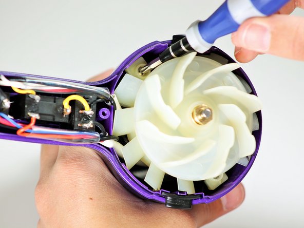

  4. Conair Infiniti Pro Model 259NP Fan Motor Assembly Replacement, Fan Motor Assembly: crwdns2935265:04crwdnd2935265:01crwdnd2935265:02crwdne2935265:0 Conair Infiniti Pro Model 259NP Fan Motor Assembly Replacement, Fan Motor Assembly: crwdns2935265:04crwdnd2935265:02crwdnd2935265:02crwdne2935265:0
    • Hold the hair dryer by the nozzle so that the handle points to the left.
    • Remove the two 1-inch Phillips #2 screws from the back of the fan motor.

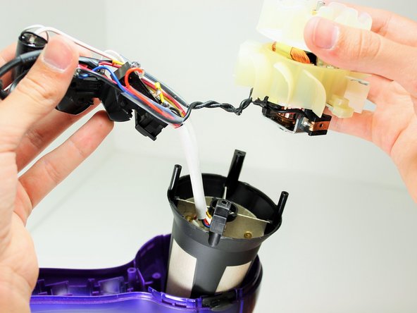

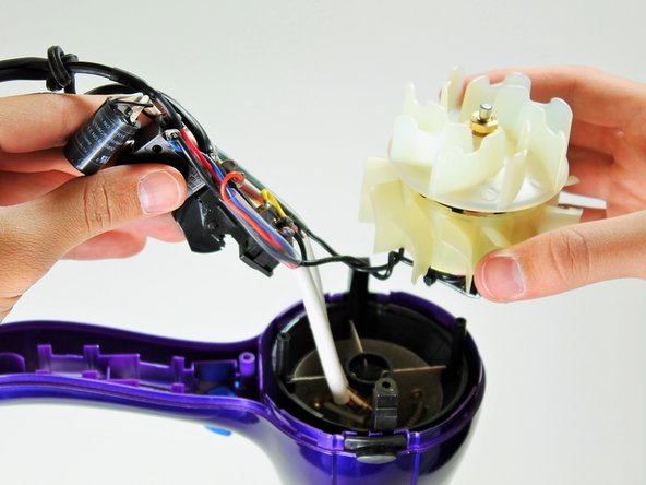

  5. Conair Infiniti Pro Model 259NP Fan Motor Assembly Replacement: crwdns2935265:05crwdnd2935265:01crwdnd2935265:03crwdne2935265:0 Conair Infiniti Pro Model 259NP Fan Motor Assembly Replacement: crwdns2935265:05crwdnd2935265:02crwdnd2935265:03crwdne2935265:0 Conair Infiniti Pro Model 259NP Fan Motor Assembly Replacement: crwdns2935265:05crwdnd2935265:03crwdnd2935265:03crwdne2935265:0
    • Caution: If you recently used the hair dryer, wait at least 10 minutes before attempting this step. The heating element may still be very hot and can cause serious burns.
    • Pull on the back of the fan motor to gently lift the motor out of the hair dryer.
    • Lift the attached electrical wiring and heat shield completely out of the hair dryer.
