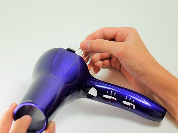

  6. Conair Infiniti Pro Model 259NP Fan Grill Replacement, Fan Grill: crwdns2935265:06crwdnd2935265:01crwdnd2935265:01crwdne2935265:0
    • Hold the front panel of the hair dryer by the nozzle facing upward.
  7. Conair Infiniti Pro Model 259NP Fan Grill Replacement: crwdns2935265:07crwdnd2935265:01crwdnd2935265:02crwdne2935265:0 Conair Infiniti Pro Model 259NP Fan Grill Replacement: crwdns2935265:07crwdnd2935265:02crwdnd2935265:02crwdne2935265:0
    • Using your index finger push the fan grill down with moderate force.
