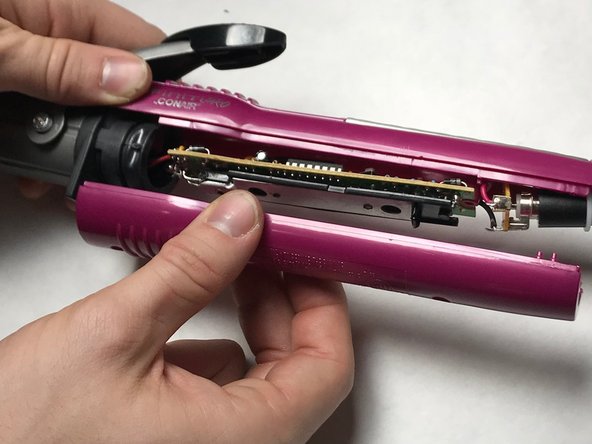

    • Remove the Philips #1 28 mm.
    • Make sure device is unplugged and cool before attempting to replace parts.
  2. Conair Infiniti PRO Curling Iron Motherboard Replacement: crwdns2935265:02crwdnd2935265:01crwdnd2935265:01crwdne2935265:0
    • Remove the Philips #1 22 mm screws.
  3. Conair Infiniti PRO Curling Iron Motherboard Replacement: crwdns2935265:03crwdnd2935265:01crwdnd2935265:03crwdne2935265:0 Conair Infiniti PRO Curling Iron Motherboard Replacement: crwdns2935265:03crwdnd2935265:02crwdnd2935265:03crwdne2935265:0 Conair Infiniti PRO Curling Iron Motherboard Replacement: crwdns2935265:03crwdnd2935265:03crwdnd2935265:03crwdne2935265:0
    • Pry off the housing using a plastic spudger.

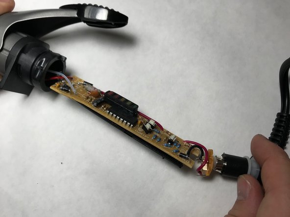

  5. Conair Infiniti PRO Curling Iron Motherboard Replacement, Motherboard: crwdns2935265:05crwdnd2935265:01crwdnd2935265:01crwdne2935265:0
    • Heat up your soldering gun and desolder the red wire from the motherboard as shown.
    • Note the location of wire attachment.
  6. Conair Infiniti PRO Curling Iron Motherboard Replacement: crwdns2935265:06crwdnd2935265:01crwdnd2935265:01crwdne2935265:0
    Desoldering Pump
    $3.99
    • With your soldering gun, desolder the white wire from the motherboard as shown.
  7. Conair Infiniti PRO Curling Iron Motherboard Replacement: crwdns2935265:07crwdnd2935265:01crwdnd2935265:01crwdne2935265:0
    • Once both wires are desoldered the motherboard can be removed.
To reassemble your device, follow these instructions in reverse order, making sure to resolder the wires correctly into the replacement motherboard.
