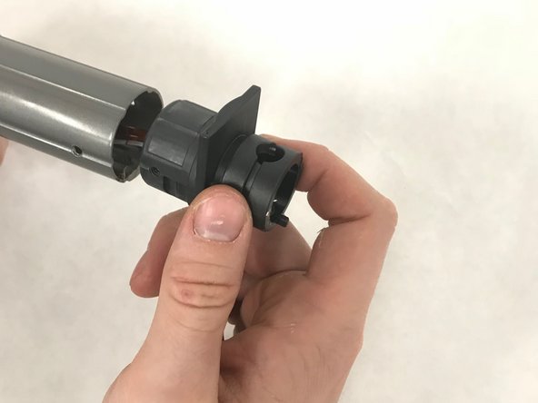

    • Remove the Philips #1 28 mm.
    • Make sure device is unplugged and cool before attempting to replace parts.
  2. Conair Infiniti PRO Curling Iron Heating Element Replacement: crwdns2935265:02crwdnd2935265:01crwdnd2935265:01crwdne2935265:0
    • Remove the Philips #1 22 mm screws.
  3. Conair Infiniti PRO Curling Iron Heating Element Replacement: crwdns2935265:03crwdnd2935265:01crwdnd2935265:03crwdne2935265:0 Conair Infiniti PRO Curling Iron Heating Element Replacement: crwdns2935265:03crwdnd2935265:02crwdnd2935265:03crwdne2935265:0 Conair Infiniti PRO Curling Iron Heating Element Replacement: crwdns2935265:03crwdnd2935265:03crwdnd2935265:03crwdne2935265:0
    • Pry off the housing using a plastic spudger.
  4. Conair Infiniti PRO Curling Iron Heating Element Replacement, Power Cord: crwdns2935265:04crwdnd2935265:01crwdnd2935265:01crwdne2935265:0
    • Pull power chord out.
  5. Conair Infiniti PRO Curling Iron Heating Element Replacement, Motherboard: crwdns2935265:05crwdnd2935265:01crwdnd2935265:01crwdne2935265:0
    • Heat up your soldering gun and desolder the red wire from the motherboard as shown.
    • Note the location of wire attachment.
  6. Conair Infiniti PRO Curling Iron Heating Element Replacement: crwdns2935265:06crwdnd2935265:01crwdnd2935265:01crwdne2935265:0
    Desoldering Pump
    $3.99
    • With your soldering gun, desolder the white wire from the motherboard as shown.
  7. Conair Infiniti PRO Curling Iron Heating Element Replacement: crwdns2935265:07crwdnd2935265:01crwdnd2935265:01crwdne2935265:0
    • Once both wires are desoldered the motherboard can be removed.
  8. Conair Infiniti PRO Curling Iron Heating Element Replacement, Heating Element: crwdns2935265:08crwdnd2935265:01crwdnd2935265:02crwdne2935265:0 Conair Infiniti PRO Curling Iron Heating Element Replacement, Heating Element: crwdns2935265:08crwdnd2935265:02crwdnd2935265:02crwdne2935265:0
    • Remove the heating element mount. This will free up the heating element barrel for replacement.
