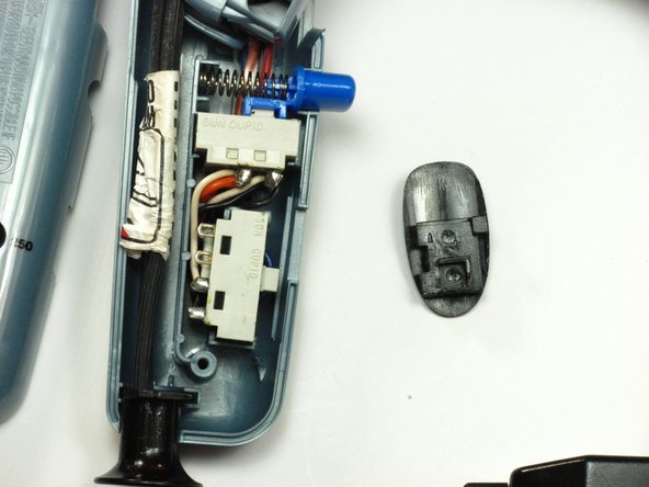

    • Unscrew the two 18 mm long Phillips #2 screws on the side of the hair dryer.
  2. Conair Cord-Keeper 169XR On/Off Switch Replacement: crwdns2935265:02crwdnd2935265:01crwdnd2935265:01crwdne2935265:0
    • Be cautious of pieces that can possibly fall out when removing the face of the handle.
    • Once you have taken the screws out, take the top half of the handle off by lifting it off of the dryer.
  3. Conair Cord-Keeper 169XR On/Off Switch Replacement, On/Off Switch: crwdns2935265:03crwdnd2935265:01crwdnd2935265:02crwdne2935265:0 Conair Cord-Keeper 169XR On/Off Switch Replacement, On/Off Switch: crwdns2935265:03crwdnd2935265:02crwdnd2935265:02crwdne2935265:0
    • Now take out the On/Off switch by gently pulling it out towards you and lightly pushing it to the right with your finger until it comes out of the groove it is resting in.
    • Once the new switch is in place you can put the dryer back together.
