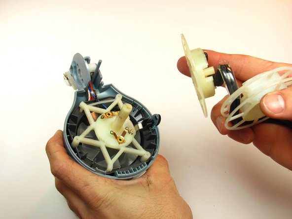

  11. Conair Cord-Keeper 169XR Cord Retracting Mechanism Replacement: crwdns2935265:011crwdnd2935265:01crwdnd2935265:03crwdne2935265:0 Conair Cord-Keeper 169XR Cord Retracting Mechanism Replacement: crwdns2935265:011crwdnd2935265:02crwdnd2935265:03crwdne2935265:0 Conair Cord-Keeper 169XR Cord Retracting Mechanism Replacement: crwdns2935265:011crwdnd2935265:03crwdnd2935265:03crwdne2935265:0
    • Once the coil is removed, unscrew the three 11 mm long Phillips #2 screws underneath to remove the retracting wheel.
  12. Conair Cord-Keeper 169XR Cord Retracting Mechanism Replacement, Cord Retracting Mechanism: crwdns2935265:012crwdnd2935265:01crwdnd2935265:02crwdne2935265:0 Conair Cord-Keeper 169XR Cord Retracting Mechanism Replacement, Cord Retracting Mechanism: crwdns2935265:012crwdnd2935265:02crwdnd2935265:02crwdne2935265:0
    • Remove the two parts of the retracting wheel.
