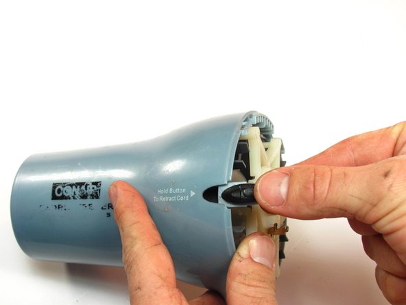

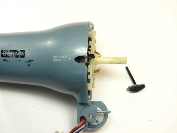

  12. Conair Cord-Keeper 169XR Cord Retracting Button Replacement, Cord Retracting Button: crwdns2935265:012crwdnd2935265:01crwdnd2935265:03crwdne2935265:0 Conair Cord-Keeper 169XR Cord Retracting Button Replacement, Cord Retracting Button: crwdns2935265:012crwdnd2935265:02crwdnd2935265:03crwdne2935265:0 Conair Cord-Keeper 169XR Cord Retracting Button Replacement, Cord Retracting Button: crwdns2935265:012crwdnd2935265:03crwdnd2935265:03crwdne2935265:0
    • Once the retracting wheel is off, you can get to the retracting button and gently remove it by pulling it out of the groove it is resting in.
    • Now you just need to replace it with a new one. (The stem of your button may have broken and stopped activating the retracting wheel).
