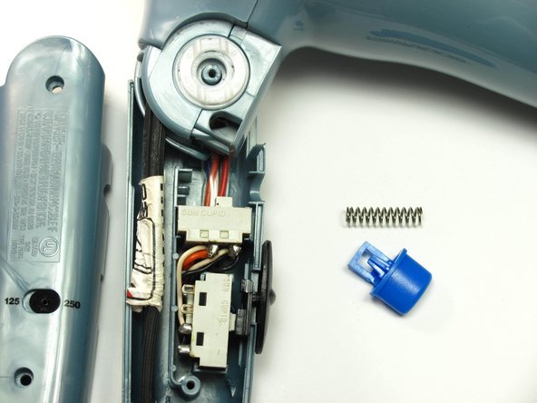

    • Unscrew the two 18 mm long Phillips #2 screws on the side of the hair dryer.
  2. Conair Cord-Keeper 169XR Cool Down Button Replacement: crwdns2935265:02crwdnd2935265:01crwdnd2935265:01crwdne2935265:0
    • Be cautious of pieces that can possibly fall out when removing the face of the handle.
    • Once you have taken the screws out, take the top half of the handle off by lifting it off of the dryer.
  3. Conair Cord-Keeper 169XR Cool Down Button Replacement, Cool Down Button: crwdns2935265:03crwdnd2935265:01crwdnd2935265:02crwdne2935265:0 Conair Cord-Keeper 169XR Cool Down Button Replacement, Cool Down Button: crwdns2935265:03crwdnd2935265:02crwdnd2935265:02crwdne2935265:0
    • Take out the cool down button and the spring behind it by gently lifting the button up toward you and pushing it to the right out of its groove.
    • You may need to replace the button and spring depending on which one is broken.
