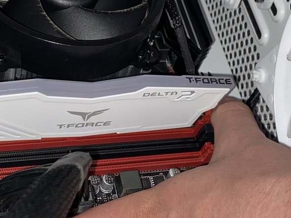

    5. Computer RAM Replacement: crwdns2935265:05crwdnd2935265:01crwdnd2935265:03crwdne2935265:0 Computer RAM Replacement: crwdns2935265:05crwdnd2935265:02crwdnd2935265:03crwdne2935265:0 Computer RAM Replacement: crwdns2935265:05crwdnd2935265:03crwdnd2935265:03crwdne2935265:0
      • Each motherboard is different. This motherboard (MSI B450 Gaming Plus Max) has two pull tabs on each side. Push down on them to release each card.
      • If you are not using this motherboard, your motherboard may only have one pull tab instead of one on each side. Please refer to the manual for your motherboard.
    6. Computer RAM Replacement: crwdns2935265:06crwdnd2935265:01crwdnd2935265:01crwdne2935265:0
      • Once the pull tabs are released, remove the RAM from the RAM slots and set to the side.

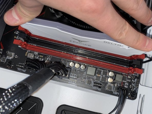

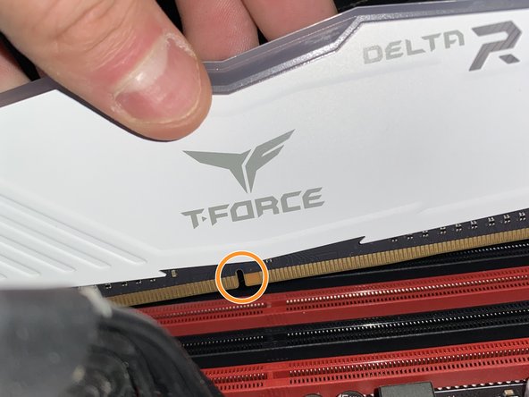

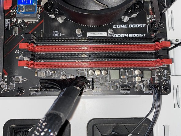

    8. Computer RAM Replacement: crwdns2935265:08crwdnd2935265:01crwdnd2935265:02crwdne2935265:0 Computer RAM Replacement: crwdns2935265:08crwdnd2935265:02crwdnd2935265:02crwdne2935265:0
      • To install new RAM, line up the notch of the RAM slot with the notch of the RAM slot on the motherboard.
      • For this motherboard, insert the RAM in the 2nd slot from left to right and the furthest one to the right.
    9. Computer RAM Replacement: crwdns2935265:09crwdnd2935265:01crwdnd2935265:02crwdne2935265:0 Computer RAM Replacement: crwdns2935265:09crwdnd2935265:02crwdnd2935265:02crwdne2935265:0
      • Push down with even pressure on both sides until you hear two clicks since on this motherboard there are two tabs, one on each side.

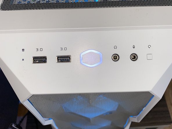

      • Power your PC by turning on the power switch on the back.
      • Press the power button on the top of the case.

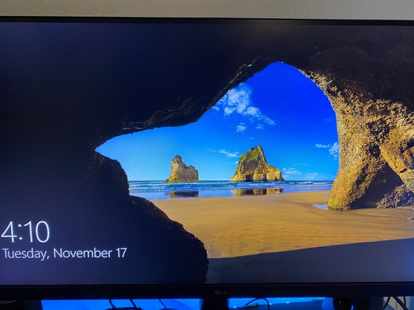

      • Stand your computer back up.
      • See if the computer powers up and into windows and shows up on your display. If it does, put the side panel back on.
      • If you do not see anything on your monitor’s display, you did not install the RAM correctly and must check to see if it's fully secured. Remove the RAM again and install again.

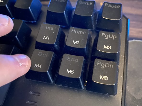

      • Check to see if your RAM is running at its rated speed.
      • Restart your PC and spam click your delete key on your keyboard until you get into the MSI BIOS.

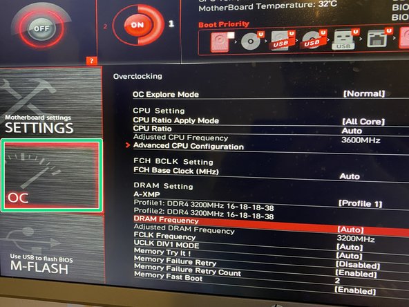

    14. Computer RAM Replacement: crwdns2935265:014crwdnd2935265:01crwdnd2935265:02crwdne2935265:0 Computer RAM Replacement: crwdns2935265:014crwdnd2935265:02crwdnd2935265:02crwdne2935265:0
      • You will know you got into your BIOS if see a screen like this. On the top section, for this RAM, it should say the DDR speed is 3200 Mhz. If you do see this, skip to the final step.
      • If you do not, with your arrow keys go to the OC section, scroll to DRAM frequency and instead of auto, select the rated speed of your RAM. (Don't forget to save this setting.)
