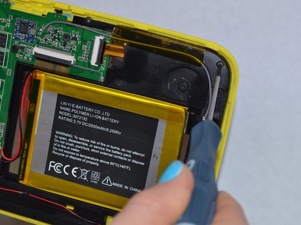

    4. Computer King Muffin Kinder 7 Screen Replacement: crwdns2935265:04crwdnd2935265:01crwdnd2935265:01crwdne2935265:0
      • The battery is glued onto the black plastic. Use the plastic opening tool to pry the battery from the black plastic

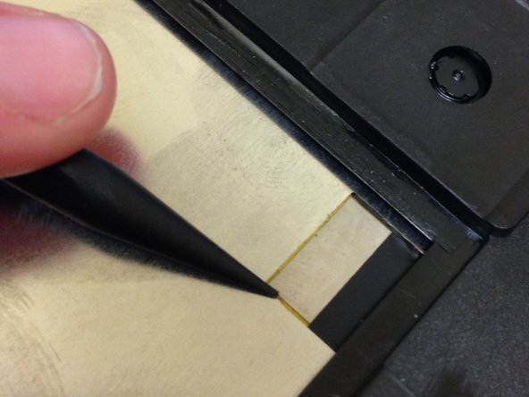

    5. Computer King Muffin Kinder 7 Screen Replacement: crwdns2935265:05crwdnd2935265:01crwdnd2935265:02crwdne2935265:0 Computer King Muffin Kinder 7 Screen Replacement: crwdns2935265:05crwdnd2935265:02crwdnd2935265:02crwdne2935265:0
      • There will be a black strip connected to the screen.
      • Use the pointy end of the spudger to unstick the black strip that is glued onto the screen.

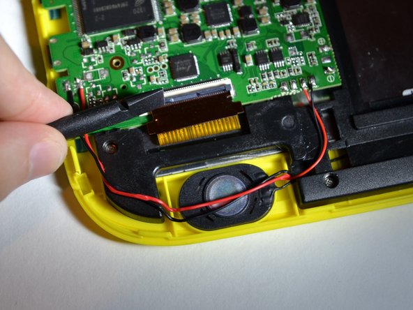

    6. Computer King Muffin Kinder 7 Screen Replacement: crwdns2935265:06crwdnd2935265:01crwdnd2935265:03crwdne2935265:0 Computer King Muffin Kinder 7 Screen Replacement: crwdns2935265:06crwdnd2935265:02crwdnd2935265:03crwdne2935265:0 Computer King Muffin Kinder 7 Screen Replacement: crwdns2935265:06crwdnd2935265:03crwdnd2935265:03crwdne2935265:0
      • You will need to remove 2 ribbon cables, one that is connected to the touch screen (by the battery) and one that is connected to the yellow plastic (by the speaker).
      • Use the flat end of the spudger to lift the black panel covering the ribbon cables.

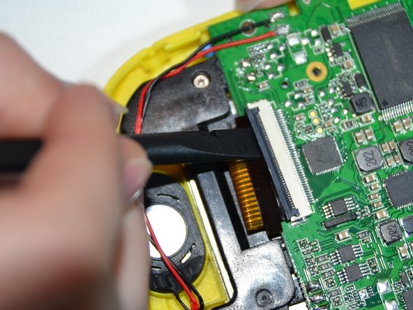

    7. Computer King Muffin Kinder 7 Screen Replacement: crwdns2935265:07crwdnd2935265:01crwdnd2935265:01crwdne2935265:0
      • Pull the two ribbon cables out so that they are no longer connected to the logic board.
