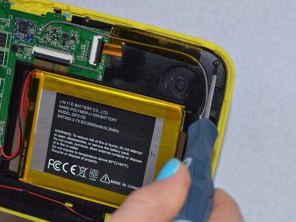

    • The battery is glued onto the black plastic. Use the plastic opening tool to pry the battery from the black plastic

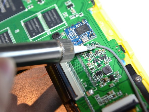

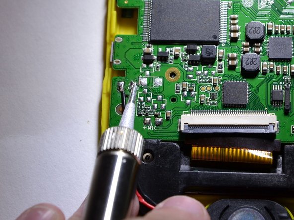

    • Unsolder the 11 red, back, and grey wires connected to the logic board.
    • Tips on how to solder can be found here.

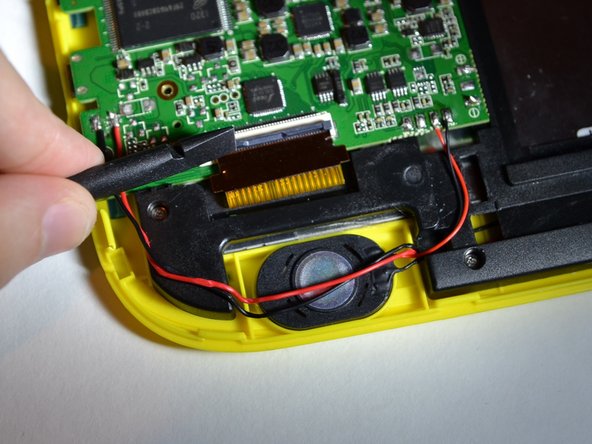

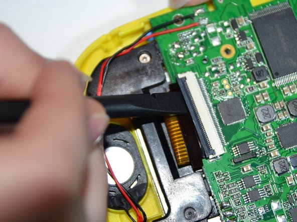

    • Use the flat end of the spudger to lift the black panels covering the three ribbon cables connected to the logic board.
  7. Computer King Muffin Kinder 7 Logic Board Replacement: crwdns2935265:07crwdnd2935265:01crwdnd2935265:01crwdne2935265:0
    • Pull the three ribbon cables out so that they are no longer connected to the logic board.
