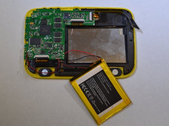

    3. Computer King Muffin Kinder 7 Battery Replacement: crwdns2935265:03crwdnd2935265:01crwdnd2935265:02crwdne2935265:0 Computer King Muffin Kinder 7 Battery Replacement: crwdns2935265:03crwdnd2935265:02crwdnd2935265:02crwdne2935265:0
      • The battery is glued onto the black plastic. Use the plastic opening tool to pry the battery from the black plastic.

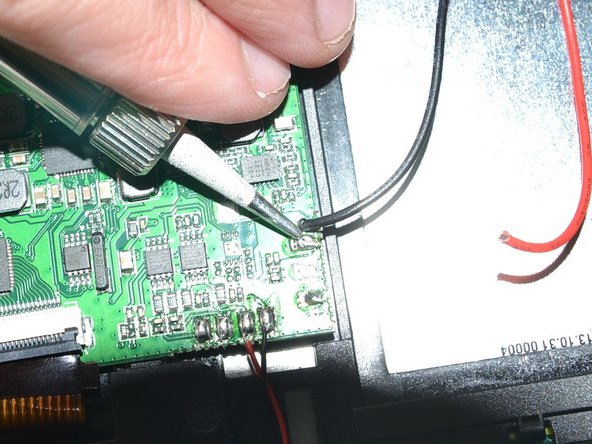

    4. Computer King Muffin Kinder 7 Battery Replacement: crwdns2935265:04crwdnd2935265:01crwdnd2935265:02crwdne2935265:0 Computer King Muffin Kinder 7 Battery Replacement: crwdns2935265:04crwdnd2935265:02crwdnd2935265:02crwdne2935265:0
      • Unsolder the red and black wires that are connected to the battery from the logic board using a soldering iron.
      • Tips on how to solder can be found here.
