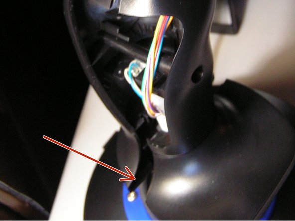

  5. Computer Game Controller t.Flight HOTAS rebuild, Separate the handle: crwdns2935265:05crwdnd2935265:01crwdnd2935265:03crwdne2935265:0 Computer Game Controller t.Flight HOTAS rebuild, Separate the handle: crwdns2935265:05crwdnd2935265:02crwdnd2935265:03crwdne2935265:0 Computer Game Controller t.Flight HOTAS rebuild, Separate the handle: crwdns2935265:05crwdnd2935265:03crwdnd2935265:03crwdne2935265:0
    • Place masking tape between the button panel and top of the right half of the handle, this will hold that assembly in place to protect the wires.
    • Separate the handle at the bottom and remove the center cover between the two halves. Set cover aside.
    • While holding the right half of the handle against the white center post, gently remove the left half of the handle with the trigger assembly and set aside.

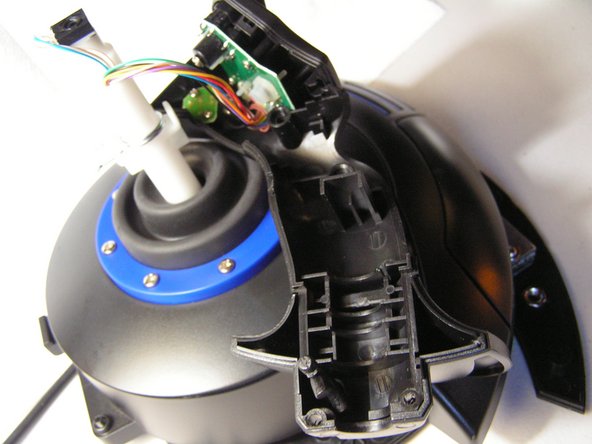

  6. Computer Game Controller t.Flight HOTAS rebuild, Expose the YAW Sensor: crwdns2935265:06crwdnd2935265:01crwdnd2935265:02crwdne2935265:0 Computer Game Controller t.Flight HOTAS rebuild, Expose the YAW Sensor: crwdns2935265:06crwdnd2935265:02crwdnd2935265:02crwdne2935265:0
    • The right half of the handle should now be free to slide off of the square sensor body at the top of the white center post.
    • Lay down next to the white center post, being careful not to stress the wires.
    • Lift the sensor body strait up and clear of the white center post. Note the orientation of the D-flat on the sensor "knob", it should be facing away from the solder tabs and towards the right half of the handle.

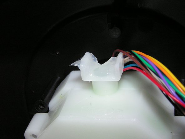

  8. Computer Game Controller t.Flight HOTAS rebuild, Encapsulating the Sensor: crwdns2935265:08crwdnd2935265:01crwdnd2935265:03crwdne2935265:0 Computer Game Controller t.Flight HOTAS rebuild, Encapsulating the Sensor: crwdns2935265:08crwdnd2935265:02crwdnd2935265:03crwdne2935265:0 Computer Game Controller t.Flight HOTAS rebuild, Encapsulating the Sensor: crwdns2935265:08crwdnd2935265:03crwdnd2935265:03crwdne2935265:0
    • Encapsulate the sensor in Silicone Grease by working it into all the openings of the part on both ends.
    • Apply grease to the opening in the top of the white center post.
    • Apply grease to square receiving notch on the right handle.
