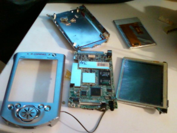

    • an original ipaq from compaq not hp
    • the teardown is realatively simple (PS: simply is not always easy)
  2. Compaq iPaq Pocket PC 3765 Teardown: crwdns2935265:02crwdnd2935265:01crwdnd2935265:03crwdne2935265:0 Compaq iPaq Pocket PC 3765 Teardown: crwdns2935265:02crwdnd2935265:02crwdnd2935265:03crwdne2935265:0 Compaq iPaq Pocket PC 3765 Teardown: crwdns2935265:02crwdnd2935265:03crwdnd2935265:03crwdne2935265:0
    • There are four torx screws here
  3. Compaq iPaq Pocket PC 3765 Teardown: crwdns2935265:03crwdnd2935265:01crwdnd2935265:03crwdne2935265:0 Compaq iPaq Pocket PC 3765 Teardown: crwdns2935265:03crwdnd2935265:02crwdnd2935265:03crwdne2935265:0 Compaq iPaq Pocket PC 3765 Teardown: crwdns2935265:03crwdnd2935265:03crwdnd2935265:03crwdne2935265:0
    • Gently pry around the edges to release the cover

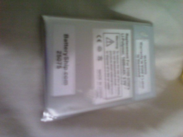

    • The battery is glued to the back cover be careful not to damage the fragile ribbon cable
    • fold the back under the front panel and carefully remove the battery connector
  4. Compaq iPaq Pocket PC 3765 Teardown: crwdns2935265:04crwdnd2935265:01crwdnd2935265:02crwdne2935265:0 Compaq iPaq Pocket PC 3765 Teardown: crwdns2935265:04crwdnd2935265:02crwdnd2935265:02crwdne2935265:0
    • x
  5. Compaq iPaq Pocket PC 3765 Teardown: crwdns2935265:05crwdnd2935265:01crwdnd2935265:02crwdne2935265:0 Compaq iPaq Pocket PC 3765 Teardown: crwdns2935265:05crwdnd2935265:02crwdnd2935265:02crwdne2935265:0

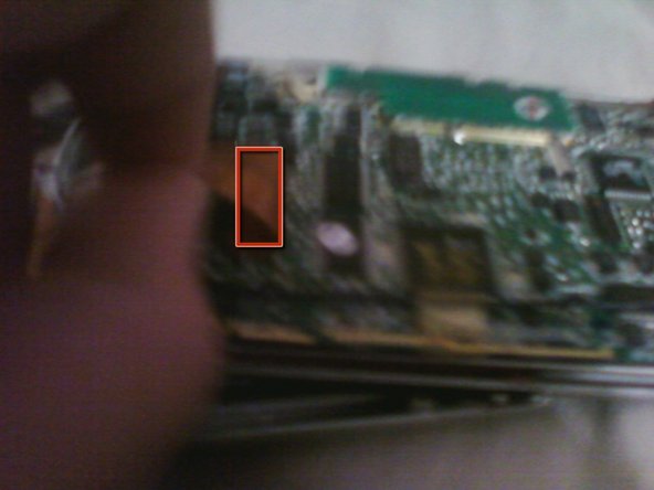

    • Disconnect the backlight
    • from the inverter
    • here is an Htc branded processor
    • be sure to pop up the black wire

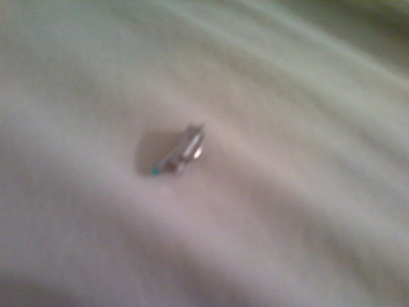

    • remove the stylus ejector
  6. Compaq iPaq Pocket PC 3765 Teardown: crwdns2935265:06crwdnd2935265:01crwdnd2935265:01crwdne2935265:0

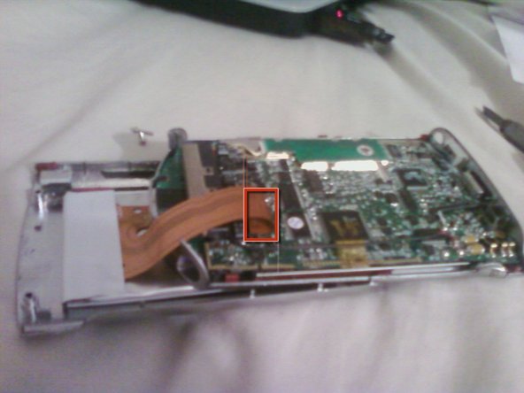

    • Gently pull on the top face while lifting the logic board (will require some force)
    • Be careful of the black wire running along the board
    • Disconnect the screen and digitizer cables being careful not to damage the cable or connector
  7. Compaq iPaq Pocket PC 3765 Teardown: crwdns2935265:07crwdnd2935265:01crwdnd2935265:01crwdne2935265:0
    • two Intel flash chips
  8. Compaq iPaq Pocket PC 3765 Teardown: crwdns2935265:08crwdnd2935265:01crwdnd2935265:03crwdne2935265:0 Compaq iPaq Pocket PC 3765 Teardown: crwdns2935265:08crwdnd2935265:02crwdnd2935265:03crwdne2935265:0 Compaq iPaq Pocket PC 3765 Teardown: crwdns2935265:08crwdnd2935265:03crwdnd2935265:03crwdne2935265:0

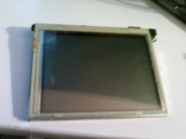

    • again putting pressure on the top panel lift the display out of the case
  9. Compaq iPaq Pocket PC 3765 Teardown: crwdns2935265:09crwdnd2935265:01crwdnd2935265:01crwdne2935265:0

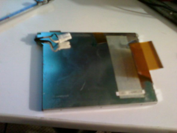

    • an htc branded control board
    • (funny I thought it said compaq on the front?)
  10. Compaq iPaq Pocket PC 3765 Teardown: crwdns2935265:010crwdnd2935265:01crwdnd2935265:02crwdne2935265:0 Compaq iPaq Pocket PC 3765 Teardown: crwdns2935265:010crwdnd2935265:02crwdnd2935265:02crwdne2935265:0
    • The final product (destroyed that is)
    • I used NO anti-static precautions, reassembled the device and after finaly getting the video cable to lock in it worked fine
    • PS: the touch panel worked But when i fixed the video cable i knocked it loose and didnt realize it and now i have to fix it (sigh)
