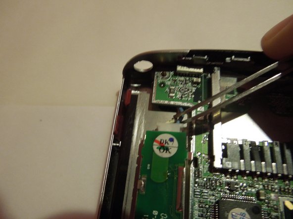

  3. Compaq iPAQ Pocket PC 3830 Speaker Replacement: crwdns2935265:03crwdnd2935265:01crwdnd2935265:01crwdne2935265:0
    • Detach the two pairs of wires, found on the top right of the motherboard, from their combs using the tweezers from the toolkit.

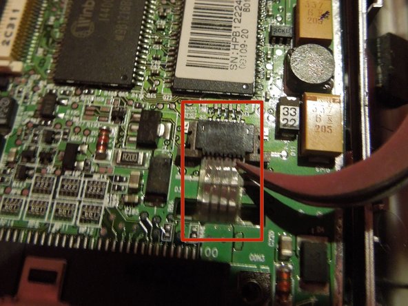

  4. Compaq iPAQ Pocket PC 3830 Speaker Replacement: crwdns2935265:04crwdnd2935265:01crwdnd2935265:02crwdne2935265:0 Compaq iPAQ Pocket PC 3830 Speaker Replacement: crwdns2935265:04crwdnd2935265:02crwdnd2935265:02crwdne2935265:0
    • In order to get to the speaker, try to free the motherboard by removing all the wires from their combs using the tweezers.

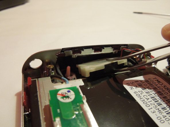

  5. Compaq iPAQ Pocket PC 3830 Speaker Replacement: crwdns2935265:05crwdnd2935265:01crwdnd2935265:02crwdne2935265:0 Compaq iPAQ Pocket PC 3830 Speaker Replacement: crwdns2935265:05crwdnd2935265:02crwdnd2935265:02crwdne2935265:0
    • Use tweezers to remove wires from combs.

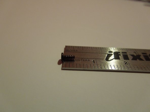

  8. Compaq iPAQ Pocket PC 3830 Speaker Replacement: crwdns2935265:08crwdnd2935265:01crwdnd2935265:03crwdne2935265:0 Compaq iPAQ Pocket PC 3830 Speaker Replacement: crwdns2935265:08crwdnd2935265:02crwdnd2935265:03crwdne2935265:0 Compaq iPAQ Pocket PC 3830 Speaker Replacement: crwdns2935265:08crwdnd2935265:03crwdnd2935265:03crwdne2935265:0
    • Unscrew the two Phillips #00 screws to get the speaker loose using a Phillips screwdriver. The screws measure 0.3 mm in length.

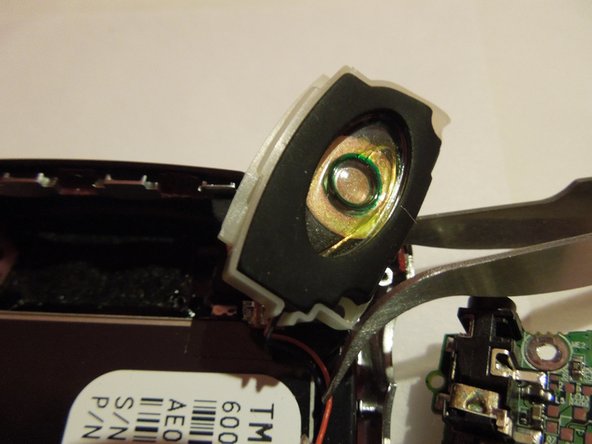

  9. Compaq iPAQ Pocket PC 3830 Speaker Replacement: crwdns2935265:09crwdnd2935265:01crwdnd2935265:02crwdne2935265:0 Compaq iPAQ Pocket PC 3830 Speaker Replacement: crwdns2935265:09crwdnd2935265:02crwdnd2935265:02crwdne2935265:0
    • Once the two screws that hold the speaker in place are removed, remove the speaker using tweezers.
