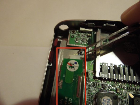

    • Detach the wires from their combs on the motherboard.
  4. Compaq iPAQ Pocket PC 3830 Motherboard Replacement: crwdns2935265:04crwdnd2935265:01crwdnd2935265:01crwdne2935265:0
    • Detach from comb that is located on motherboard.
  5. Compaq iPAQ Pocket PC 3830 Motherboard Replacement: crwdns2935265:05crwdnd2935265:01crwdnd2935265:02crwdne2935265:0 Compaq iPAQ Pocket PC 3830 Motherboard Replacement: crwdns2935265:05crwdnd2935265:02crwdnd2935265:02crwdne2935265:0
    • Remove the small piece from the motherboard.

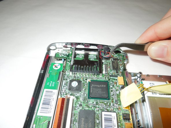

  6. Compaq iPAQ Pocket PC 3830 Motherboard Replacement: crwdns2935265:06crwdnd2935265:01crwdnd2935265:01crwdne2935265:0
    • Use tweezers to remove last piece from the comb on the motherboard.
  7. Compaq iPAQ Pocket PC 3830 Motherboard Replacement: crwdns2935265:07crwdnd2935265:01crwdnd2935265:01crwdne2935265:0
    • Remove the motherboard by simply lifting it.
