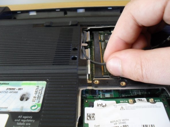

    • Loosen the two screws on the ram cover and remove
    • Loosen the one screw on the wireless card cover and remove
    • These screws will remain in their covers

    • Using a small flat blade screwdriver pop off the wireless aerial connectors from the wireless card
    • The wireless connecters are easily damaged. Lift the connecters straight up. When reassembling line them up carefully and push them straight down
    • Unroute the cables from the bottom of the case

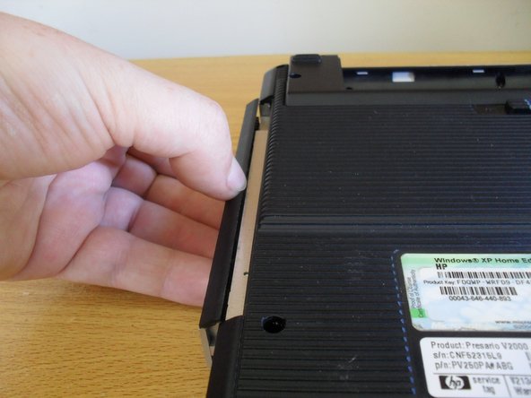

    • Slide out the dvd drive

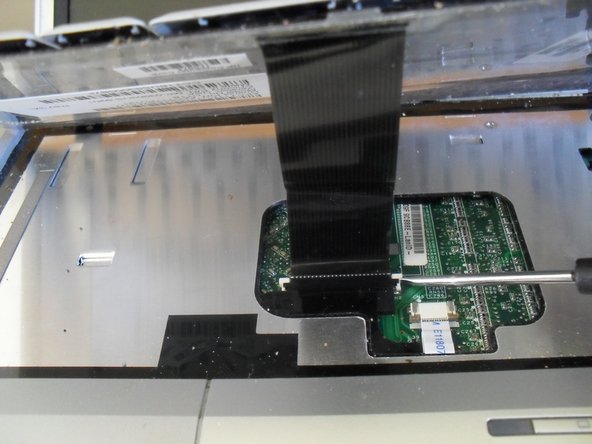

    • Lift up the keyboard, but beware of the cable underneath still to be removed
    • Loosen the socket for the keyboard cable and remove the keyboard

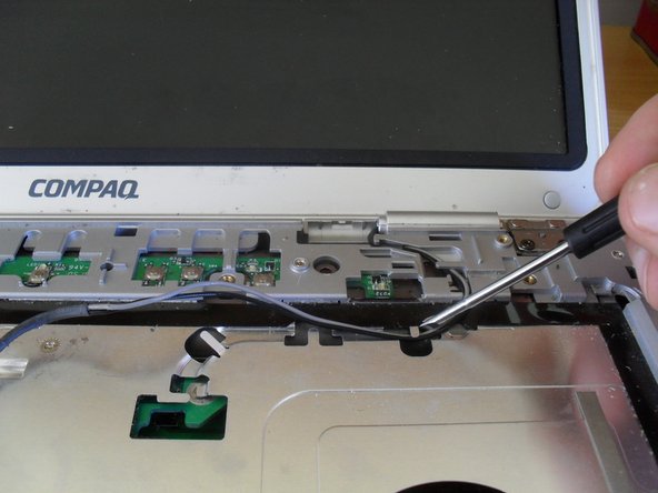

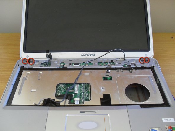

    • Remove the display cable connector by lifting it straight up
    • Un-route the wireless aerial cables from the top cover
    • Remove the four display screws (dark coloured 5mm screws). Lift the display up and off

    • Flip the laptop over and grip the bottom case where the dvd drive used to be
    • Lift off the bottom case

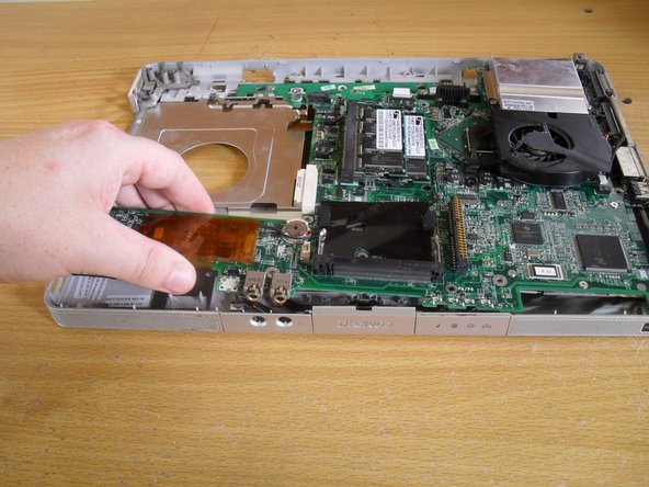

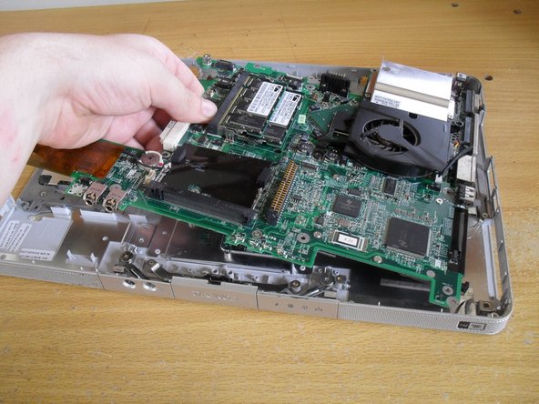

  13. Compaq Presario v2000 mother board Replacement: crwdns2935265:013crwdnd2935265:01crwdnd2935265:03crwdne2935265:0 Compaq Presario v2000 mother board Replacement: crwdns2935265:013crwdnd2935265:02crwdnd2935265:03crwdne2935265:0 Compaq Presario v2000 mother board Replacement: crwdns2935265:013crwdnd2935265:03crwdnd2935265:03crwdne2935265:0
    • Remove the left side of the motherboard first. It may be necessary to bent the case a little to get the firewire and USB port away from the case
    • Pull on the middle of the board next, angling up to clear the front audio jacks from the case
    • Pull the board away from the right side of the case
