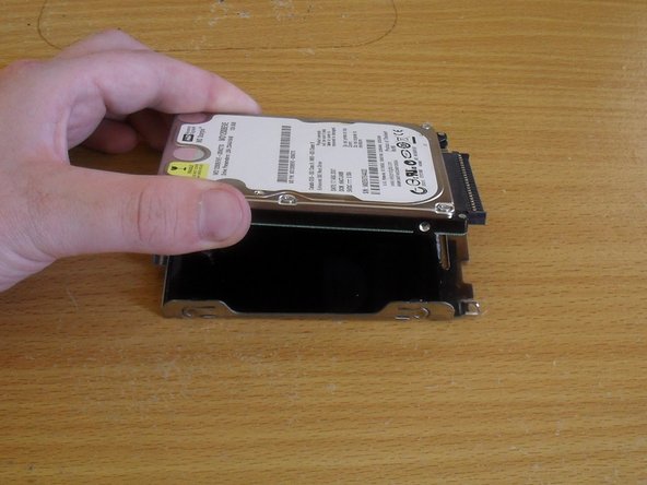

  4. Compaq Presario v2000 Hard drive Replacement: crwdns2935265:04crwdnd2935265:01crwdnd2935265:02crwdne2935265:0 Compaq Presario v2000 Hard drive Replacement: crwdns2935265:04crwdnd2935265:02crwdnd2935265:02crwdne2935265:0
    • Remove the four screws on the sides of the drive (two on each side)
    • Remove the hard drive from the caddy
  5. Compaq Presario v2000 Hard drive Replacement: crwdns2935265:05crwdnd2935265:01crwdnd2935265:01crwdne2935265:0
    • Pull the IDE connecter straight off the drive
    • Be sure to pull the connecter off straight so as not to bend the hard drive IDE pins
