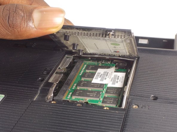

  3. Compaq Presario V2414NR WiFi Card Replacement, RAM Cover: crwdns2935265:03crwdnd2935265:01crwdnd2935265:02crwdne2935265:0 Compaq Presario V2414NR WiFi Card Replacement, RAM Cover: crwdns2935265:03crwdnd2935265:02crwdnd2935265:02crwdne2935265:0
    • Loosen the two 5mm Phillips #1 screws that secure the memory module compartment cover to the computer.
    • These screws are captured to the cover panel.
    • Lift the front edge of the memory module compartment cover and swing it back to remove it.

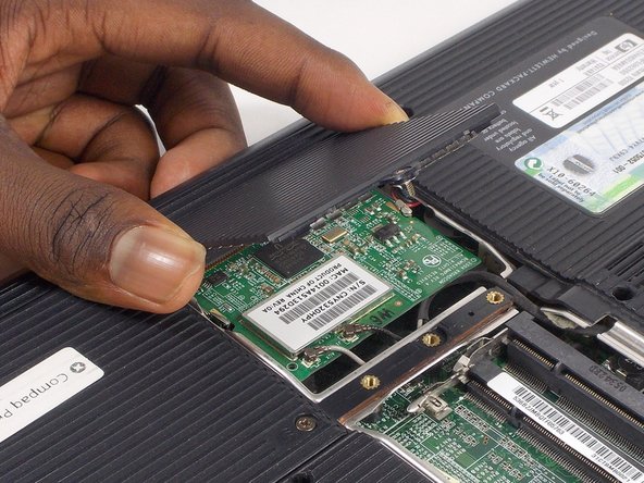

  4. Compaq Presario V2414NR WiFi Card Replacement, WiFi Card: crwdns2935265:04crwdnd2935265:01crwdnd2935265:02crwdne2935265:0 Compaq Presario V2414NR WiFi Card Replacement, WiFi Card: crwdns2935265:04crwdnd2935265:02crwdnd2935265:02crwdne2935265:0
    • Loosen the 5mm Phillips #1 screw that secures the Mini PCI compartment cover to the computer.
    • This screw is captured to the cover panel.
    • Lift the rear edge of the Mini PCI compartment cover, and swing it forward to remove it.

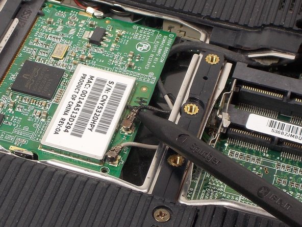

  5. Compaq Presario V2414NR WiFi Card Replacement: crwdns2935265:05crwdnd2935265:01crwdnd2935265:02crwdne2935265:0 Compaq Presario V2414NR WiFi Card Replacement: crwdns2935265:05crwdnd2935265:02crwdnd2935265:02crwdne2935265:0
    • Make note of which cable is attached to which clip on the WiFi card before disconnecting the cables.
    • Disconnect the wireless antenna cables from the WiFi card by prying gently upwards on the metal part of the connector with a spudger or plastic opening tool.

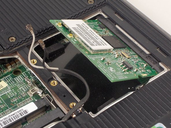

  6. Compaq Presario V2414NR WiFi Card Replacement: crwdns2935265:06crwdnd2935265:01crwdnd2935265:02crwdne2935265:0 Compaq Presario V2414NR WiFi Card Replacement: crwdns2935265:06crwdnd2935265:02crwdnd2935265:02crwdne2935265:0
    • Use your fingernails, or plastic opening tools, to spread the metal retaining tabs on each side of the WiFi card outwards until the card pops up.
    • Pull the WiFi card out of the socket at the same angle it is now oriented.
    • When reassembling, align the offset notch on the WiFi card contacts with the tab on the socket and insert at a 30 degree angle.
