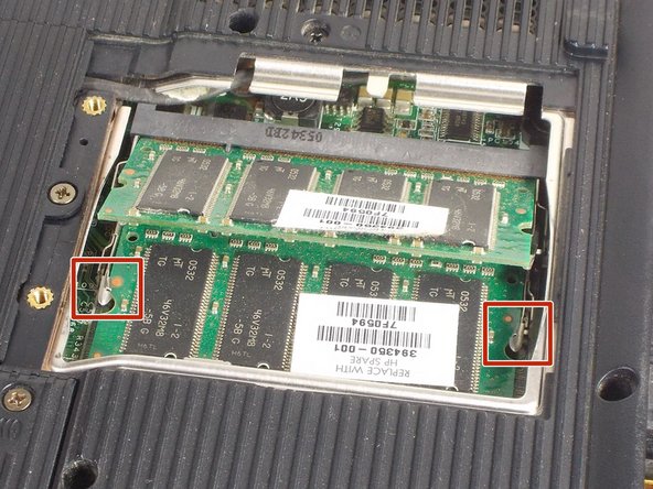

  4. Compaq Presario V2414NR RAM Replacement, RAM: crwdns2935265:04crwdnd2935265:01crwdnd2935265:02crwdne2935265:0 Compaq Presario V2414NR RAM Replacement, RAM: crwdns2935265:04crwdnd2935265:02crwdnd2935265:02crwdne2935265:0
    • Use your fingers, or plastic opening tools, to spread the metal retaining tabs on each side of the RAM outwards until the module pops up.
    • Pull the module out of the socket at the same angle it is now oriented.
    • Repeat these steps to remove the second memory module.
    • When reassembling, align the offset notch on the RAM contacts with the tab on the socket and insert at a 30 degree angle.
