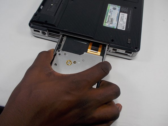

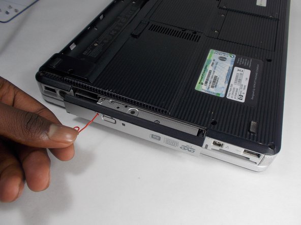

  3. Compaq Presario V2414NR Optical Drive Replacement, Optical Drive: crwdns2935265:03crwdnd2935265:01crwdnd2935265:02crwdne2935265:0 Compaq Presario V2414NR Optical Drive Replacement, Optical Drive: crwdns2935265:03crwdnd2935265:02crwdnd2935265:02crwdne2935265:0
    • On the optical drive there is small pin hole. Insert a paperclip or similarly sized object in the hole.
    • The Drive will pop a short way out of the computer.

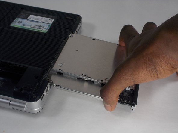

  4. Compaq Presario V2414NR Optical Drive Replacement: crwdns2935265:04crwdnd2935265:01crwdnd2935265:03crwdne2935265:0 Compaq Presario V2414NR Optical Drive Replacement: crwdns2935265:04crwdnd2935265:02crwdnd2935265:03crwdne2935265:0 Compaq Presario V2414NR Optical Drive Replacement: crwdns2935265:04crwdnd2935265:03crwdnd2935265:03crwdne2935265:0
    • Remove the 7mm Phillips #1 screw that secures the optical drive to the computer.
    • Grip the sides of the Optical Drive and slide it out until it is completely removed from the computer.
    • When reassembling, slide the optical drive straight in until it clicks.
